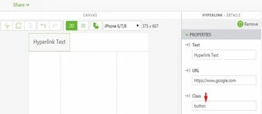

    Oct 10, 2018 5:46 PM UTC
    One alternative could be making the hyperlink widget look like a button by adding some css to it. Or you can use the "button" class under the Hyperlink widget Properties as shown below:
    Hope this helps!
