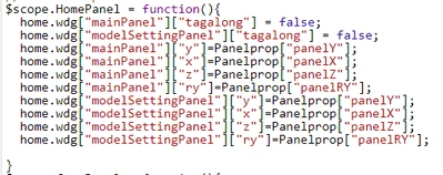

Any thoughts on how to re-position a 3D panel for Hololens?
Once it's tethered, the panel can go anywhere.  I'd like to reset it's position and have tried directly adjusting the X,Y,Z and RX, RY, RZ, but that only seems to halfway work.  I've also tried attaching those properties to application attributes and adjusting there with the same results.  I've also adjust before un-tethering and after.  Various results, but mostly the panel ends up in a weird position in space.

I tried it out and used  $scope.view.wdg["3DPanel-1"].x=0; but unfortunately the tagalong won't work at all for me. Clicking on the pin head causes in switching the symbol but nothing else happens. Also, I realized that copy & pasting buttons within the panel will crash the button.

setting the initial position of the panel once the model is loaded works fine. but after that the only panel property it seems to affect is the "tagalong".
