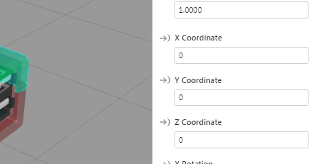

Hi Giuseppe. I was able to get the model coordinates to show on a label within the experience doing the following:
  1. Set up App parameters xpos, ypos, zpos
    2. Create 3 2D or 3D labels within your experience to display the coordinate values
    3. Create a button with title 'show coordinates'
    4. Bind xpos, ypos, & zpos to each corresponding label 'text' property.
    5. Add code to Home.js
      $scope.showCoords = function(){
                           var Xpos = document.querySelector('#model-1').getAttribute("x");
                           $scope.app.params.xpos = Xpos;
                           var Ypos = document.querySelector('#model-1').getAttribute("y");
                           $scope.app.params.ypos = Ypos;
                           var Zpos = document.querySelector('#model-1').getAttribute("z");
                           $scope.app.params.zpos = Zpos;
    6. Call showCoords(); on button click
    7. Save & publish.
Here is what my preview looks like
tmccombie21-Topaz IAnswer
    7. Save & publish.
November 16, 2017
Great Tara,
works perfectly, thank you for the precious help.
