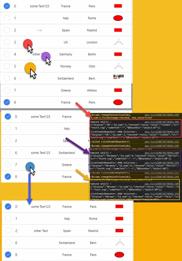

Hi everyone,
I am trying to remove a selected item within a repeater when the delete button is clicked. However, nothing is removed on click.
Delete button event JS:
Here are the codes:
var items = [
{"ID":1, "Name":"Johnny", "value": 21},
{"ID":2, "Name":"Dog", "value": 30},
{"ID":3, "Name":"Cat", "value": 45}
$scope.$on($scope.app.params["items"] = items);
$scope.removeOrder = function(item){
let removeOrders = $scope.items.indexOf(item);
$scope.items.splice(removeOrders, 1);
$scope.$applyAsync();
May 29, 2020 6:54 AM UTC
In Javascript code provided, we can see that the items JSON array is affected to app Parameter named items.
But in removeOrder Function, it seems items JSON array who is updated, not the app Paramters.
By adding some verbose in removeOrder Function, is it possible to check the values in JSON array and in app Parameter ?
When testing, it will confirm, or not, this possible root cause.
Best regards,
Samuel
May 29, 2020 8:15 AM UTC
I did have in  the past a  similar issue and modifed and tested it  according your question - it was working fine. Here the sample code I used:
var ItemList = [
 {"display":"France","id_num":0,"checked":true,"value":"Paris" ,"src":"test.svg","someText":"some Text123"},
 {"display":"Italy","id_num":1,"checked":false,"value":"Rome" ,"src":"test1.svg","someText":""},
 {"display":"Spain","id_num":2,"checked":false,"value":"Madrid" ,"src":"test2.svg","someText":""},
 {"display":"UK","id_num":3,"checked":false,"value":"London" ,"src":"test3.svg","someText":""},
 {"display":"Germany","id_num":4,"checked":false,"value":"Berlin" ,"src":"test4.svg","someText":"-->"},
 {"display":"Norway","id_num":5,"checked":false,"value":"Oslo" ,"src":"test.svg","someText":""},
 {"display":"Switzerland","id_num":6,"checked":false,"value":"Bern" ,"src":"test1.svg","someText":""},
 {"display":"Greece","id_num":7,"checked":false,"value":"Athens" ,"src":"test2.svg","someText":""},
 {"display":"France","id_num":8,"checked":true,"value":"Paris" ,"src":"test3.svg","someText":"other Text"}

$scope.$on('$ionicView.afterEnter', function() {
 //set the parameter ItemList to the value of ItemList
 $scope.app.params["ItemList"] = ItemList;
var removed_object={};
//this is the new test where remove the item
$scope.removeItemInJson= function (obj,id_num,field2change)
 console.warn("$scope.changeValueInJson(obj, id_num="+id_num+",field2change="+field2change+", )")
try{if( obj[0][field2change]==undefined) return;}catch(wrong){console.error("error::"+wrong);return;}
for (var i = 0; i < obj.length; i++){
 if (obj[i]['id_num'] == id_num){
 removed_object=obj.splice(i,1); break;}}
 // console.log("new OBJ:");console.warn(obj)
 $scope.app.params["ItemList"] = "";
 $scope.app.params["ItemList"] = JSON.parse(JSON.stringify(obj));//check value
 console.log("removed obj["+i+"] ="+JSON.stringify(removed_object))

twx.app.fn.clickItemInRepeater = function(item,list,isMultiSelect)
console.warn("called clickItemInRepeater()");
 //console.log("twx.app.fn.clickItemInRepeater item"); console.warn(item);
 //console.log("twx.app.fn.clickItemInRepeater list"); console.warn(list);
 //console.log("twx.app.fn.clickItemInRepeater isMultiSelect"); console.warn(isMultiSelect);
 // $scope.changeValueInJson(list,item.id_num,'checked', item.checked?false:true)
 $scope.removeItemInJson(list,item.id_num,'checked')
 console.log("clickItemInRepeater::ROW Selected:: "+JSON.stringify(item))
 $scope.setWidgetProp('textArea-2','text',JSON.stringify(item))
So when I test it  - I had the following behavior:
May 29, 2020 8:27 AM UTC
Here the test project uploaded
