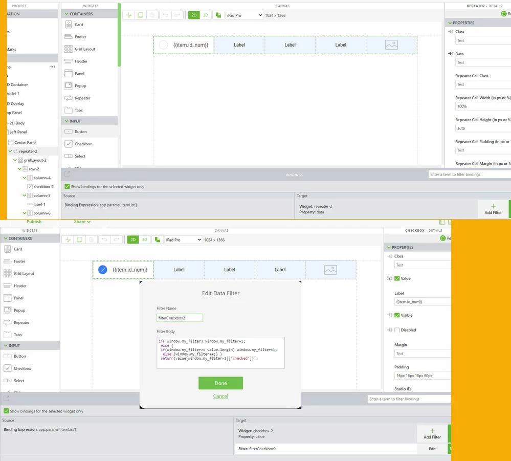

thanks for the feedback.

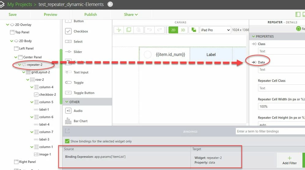

The first point is to link/bind the app parameter to the repeater data
and the second point is to bind the checkbox of the repeater to the item list. I did not find any other possibility, so Used a filter which is called for each item and will count . The count is on the windows here my_filter. I did not find other way to pass some static variable between the different filter calls
if(!window.my_filter) window.my_filter=1;
 else {
 if(window.my_filter>= value.length) window.my_filter=1;
 else {window.my_filter++;} }
 return(value[window.my_filter-1]['checked']);
This could is called for each item of the list. So the value is the passed list. And via my_filter which is the count for the called elements I will pass the correct checked property of the list.

>>> on Load of view I will set this list to a app param here e.g. "ItemList":
$scope.$on('$ionicView.afterEnter', function() {
 //set the parameter ItemList to the value of ItemList
 $scope.app.params["ItemList"] = ItemList;
And  I will create a  dependencies from app param to the repeater data property
Later testing in preview this will have the following display:

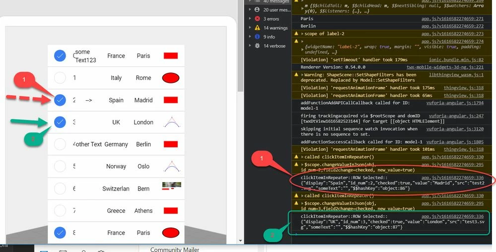

>>>In the repater I want also to handle the click selection on the checkbox and to display some svg files from the upload folder. To handle the click I used some code like (not the best example but it works) :
twx.app.fn.clickItemInRepeater = function(item,list,isMultiSelect)
console.warn("called clickItemInRepeater()");
 console.warn(isMultiSelect);
 $scope.changeValueInJson(list,item.id_num,'checked', item.checked?false:true)
 console.log("clickItemInRepeater::ROW Selected:: "+JSON.stringify(item))
 $scope.setWidgetProp('textArea-2','text',JSON.stringify(item))
 $scope.$applyAsync();

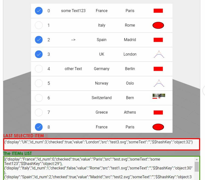

>>> so display the results in text widgets:
I attached the demo project to this post. I hope it could be helpful.
 else {

1. When writing Obj to application parameter you have to use $scope.app.params["ItemList"] = JSON.parse(JSON.stringify(obj)); otherwise, the object will be written in the app-parameter, but it will not refresh the widgets!
2. The filters will always be called two times. this is, why we have to make it so complicated. Otherwise it will only display every second entry!
3. value is the content of the application parameter, which will be filtered.
window is all content, that is displayed in your browser window, just below this level, your filter is located. The filter just contains a number that describes, which line of the object we want to read. so if it is the first entry, then my_filter is 1 and it returns the value assigned to app-parameter[0]['checked']
You can have a look at "window" by clicking here: whity_1-1626089904055.png , then open console and type window. You can now find the filters in this list:
