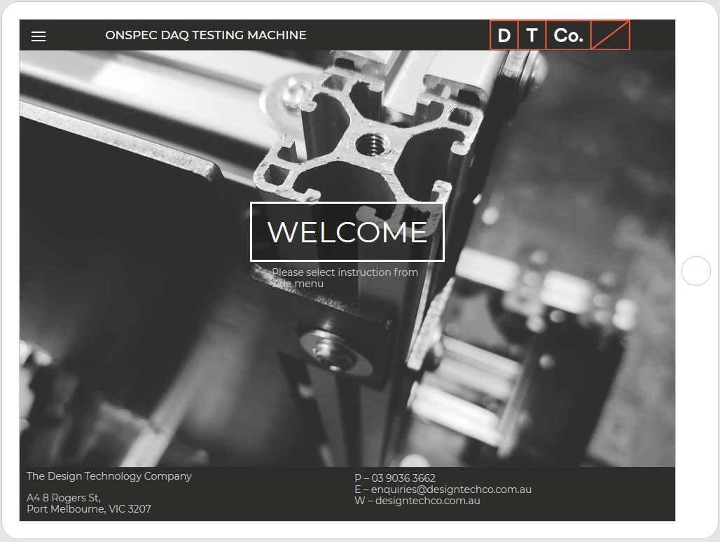

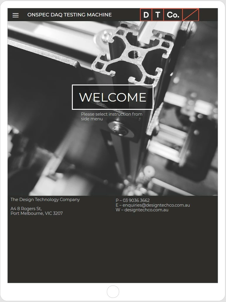

I'm having trouble getting the background on a 2D view to change size depending on screen orientation.
I have a grid layout with 3 rows, with the background applied to the 2nd row.
.row2 {
height: 80%;
background-color:#2e2d2c;
background-image: url(#{$resources}/Default/Background.jpg) !important;
background-repeat: no-repeat;
background-size: cover;
I think I need to include some flexbox and/or some positioning values to the rows, but not too sure.

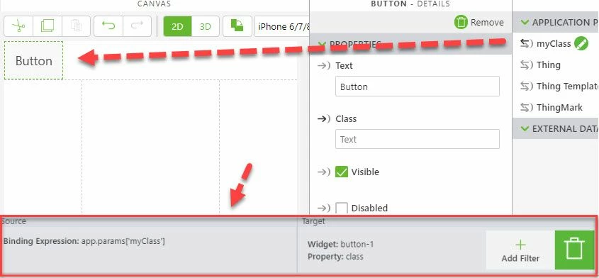

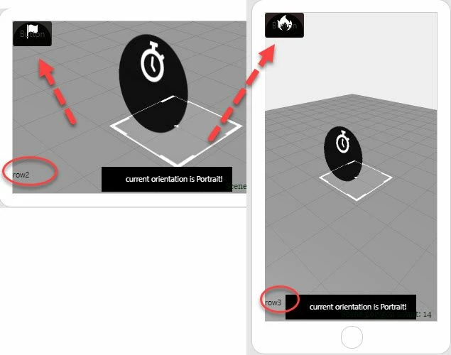

some code like this:
angular.element(document).ready(function() {
 angular.element(window).on('resize', function(evt) {
 console.log("resized window evnt : at Time ::"+$scope.getTime());
 console.warn(evt);
 var message = ''
 var win = evt.path[0];
 if(win.innerWidth > win.innerHeight){
 // LANDSCAPE -> do something here call your landscapeFunc()
 message = "current orientation is Landscape!"
 $scope.app.params['myClass']='row2'
 $scope.$applyAsync();
 else {
 // LANDSCAPE -> do something here your PortraitFunc()
 message = "current orientation is Portrait!"
 $scope.app.params['myClass']='row3'
 twx.app.fn.addSnackbarMessage(message,"twLogo");
using some css style defintion like this:
.row2 {
height: 80%;
background-image: url(#{$resources}/Default/vu_flag.svg) !important;
.row3 {
height: 50%;
background-color:#2e2222;
background-image: url(#{$resources}/Default/vu_flame.svg) !important;
The code will set dynamically an application parameter e.g. "myClass" which has a binding to the class property of a button.(this css definition has here no real sense but should only demonstrate the functionality)
