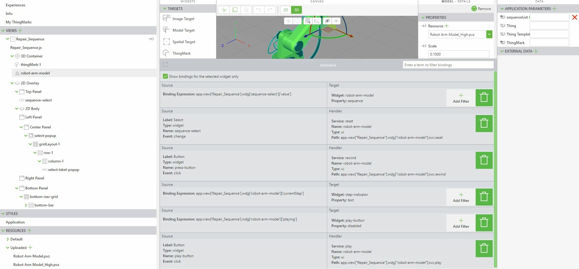

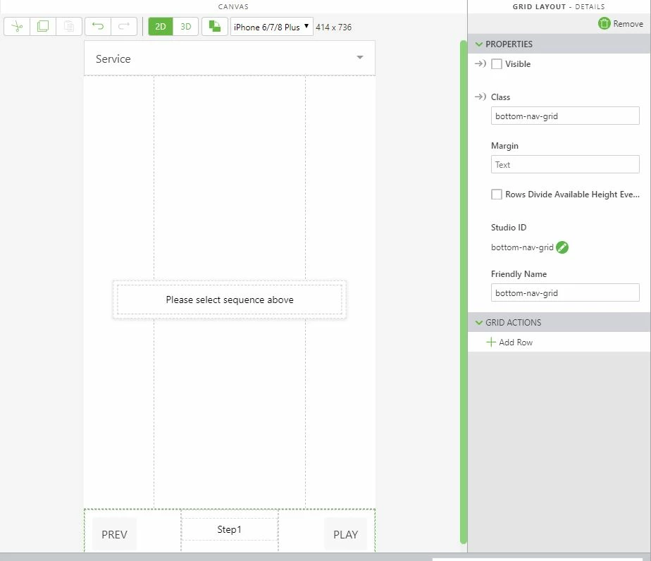

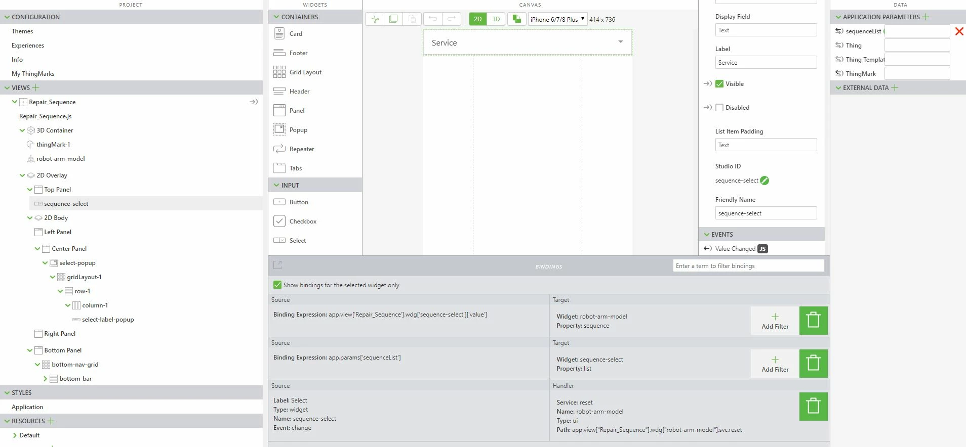

I folowed each step - Creating UI with the same ID - Binding everything step by step - Adding javascript as-is but unfortunatly is doesn't work. I verified the code and the selectionSequence Fundtion is not working. ID's are matching.

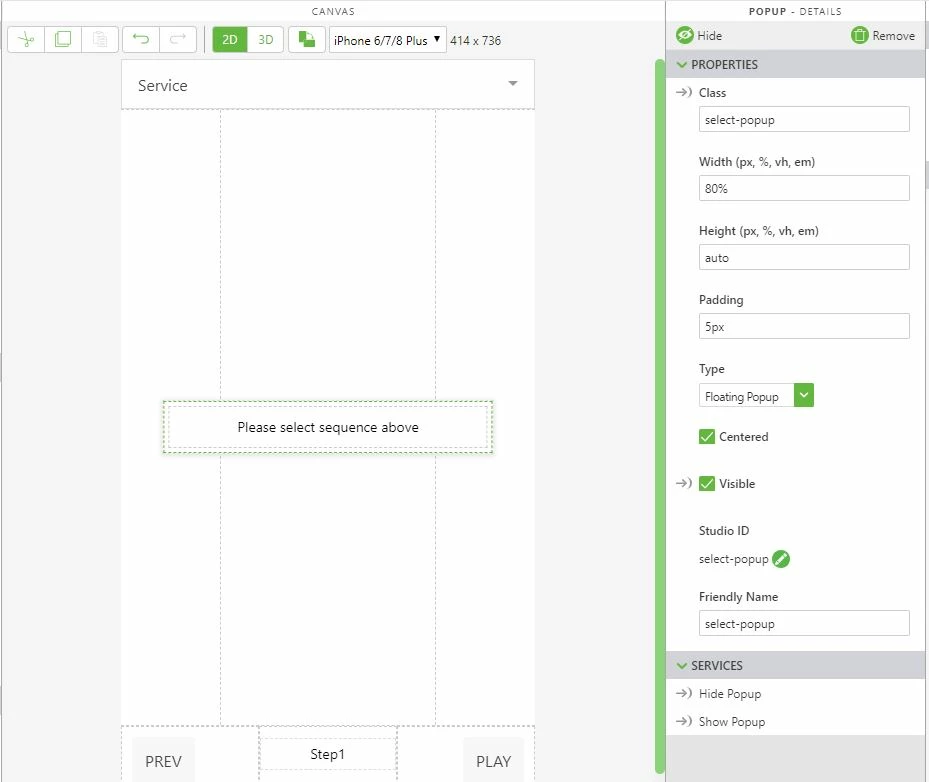

When i select a service the popup stay there and the bottom-nav-grip won't show.
Code used (SequenceList fuction work):

Hi @Subyforever ,
Thank you for sharing the screenshots! I see from the screenshots that the View name is 'Repair_Sequence'. Could you please change the view name in the below code and test the experience.

@ytella,
Unfortunately it doesn't work.
First I changed the code to "Repair_Sequence"
Then I tried to rename "Repair_Sequence" from the view name to "RepairSequence" and keep the original script as is but same result.
