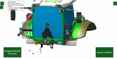

I want to make an interactive repair tutorial using Vuforia. In order to play the different video sequences created in Illustrate one after the other, I need to add selection buttons to play the corresponding video. I would like to know how to link the videos one by one. Is there a code for this?

I'm not sure if I clearly understand the question and whether you want to switch and activate animations/sequences created and stored in PVZ exported from Creo Illustrate or just show different video files, created with Creo Illustrate.
Nevertheless, in any case, you just need to dynamically change a corresponding property of the corresponding widget (the 'sequence' property of the 3Dmodel widget or 'source' for Video / 3D video widget).
This has been discussed earlier - check these links for samples / details:
https://community.ptc.com/t5/Vuforia-Studio/How-to-write-JS-to-animate-sequence-step-by-step/m-p/616300
https://community.ptc.com/t5/Vuforia-Studio/How-to-switch-between-sequences-in-Vuforia-Studio/m-p/622464
