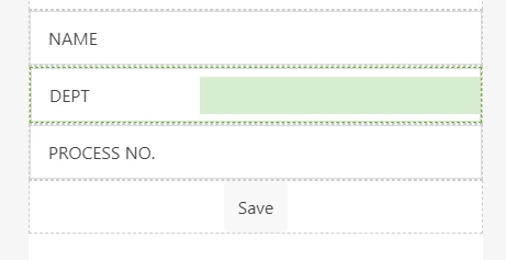

saving a text input in vuforia
hi all,
I created a textarea in vuforia, how can i save this and where does the data goes?
Jan 24, 2020 8:45 AM UTC
Hi @potatochips ,
my opinion is that a good way to solve this problem ->  is to write a data to a json file (local in session) and then save the json file to the server. Here is one example how to save a json file to repository
