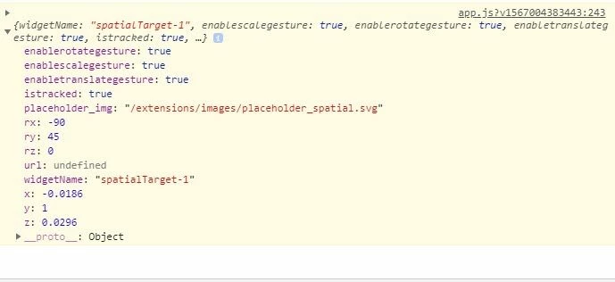

The problem is that so far I know the model scale is not the same as  the scale of the gesture scale (Spatial Target  widget property  ' Enable Scale Gesture ' is selected ) The scale using gesture is a property of the spatial target and some factor which will scale all models in the project (this is similar if you scale a thingmark size). The model widget scale property scales only a particular model. For example, if you have more than one model we can see that gesture scale will scale all models but the model scale will scale only a particular model. So the “Reset Gesture changes” will reset all changed of the gesture scale but it will not change the model widget scale property. what I believe here  is that you want  to change directly the scale of spatial target.
I tried to check the properties of this widget (not only the visible)
We can see there are some additional properties what we can change via JavaScript code
Example:
$scope.view.wdg['spatialTarget-1']['y']= $scope.view.wdg['spatialTarget-1']['y']+0.2
But I do not think that this could be helpful in your case
