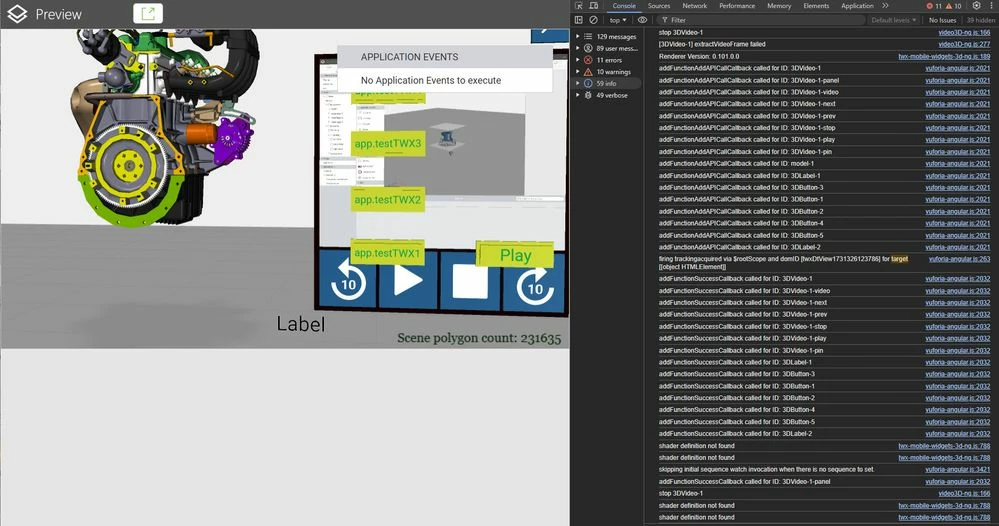

Hi @MA8731174, that is a good point. The preview should simulate the experience behavior in Studio UI is not consitent enough so that  but its allow to preview the project when it does not have any  targets definition.  No errors or warning. The most functionality is working. That may lead sometimes not to detect that targets defintions is missed.2024-11-11_12-59-43.jpg
