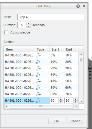

    Check your sequence in Illustrate.  It execute each movement according a percentage.  So the complete movement is 100%.  You need to set each movement (item) be a certain percentage.   Adjust the percentage for the amount of time you want each step to use out of the total time of the sequence.
    As you see here my step run for 3.5 seconds and I have each movement take 10% of the 3.5 seconds to run.  Hope this helps.
