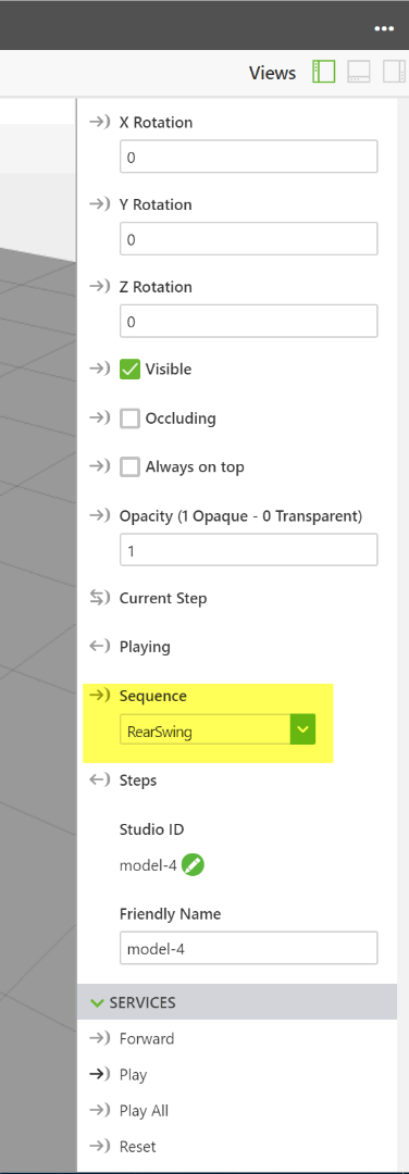

Hi
i have created some sequences creo illustrate and i would like to play these in Thingworx studio.
In illustrate i have pressed publish and get i  pvz. file, which i uploaded to studio .
But after i published i could not see the ​sequences ( i also made a play button ).
So i hope somebody can help me.
Thanks.
Alperen

mschuetzAnswer
Nov 10, 2017 3:56 PM UTC
on the model widget is a drop down for sequences. you can simply choose your sequence from here. No need for renaming, unzipping or manually adding of pvi files.

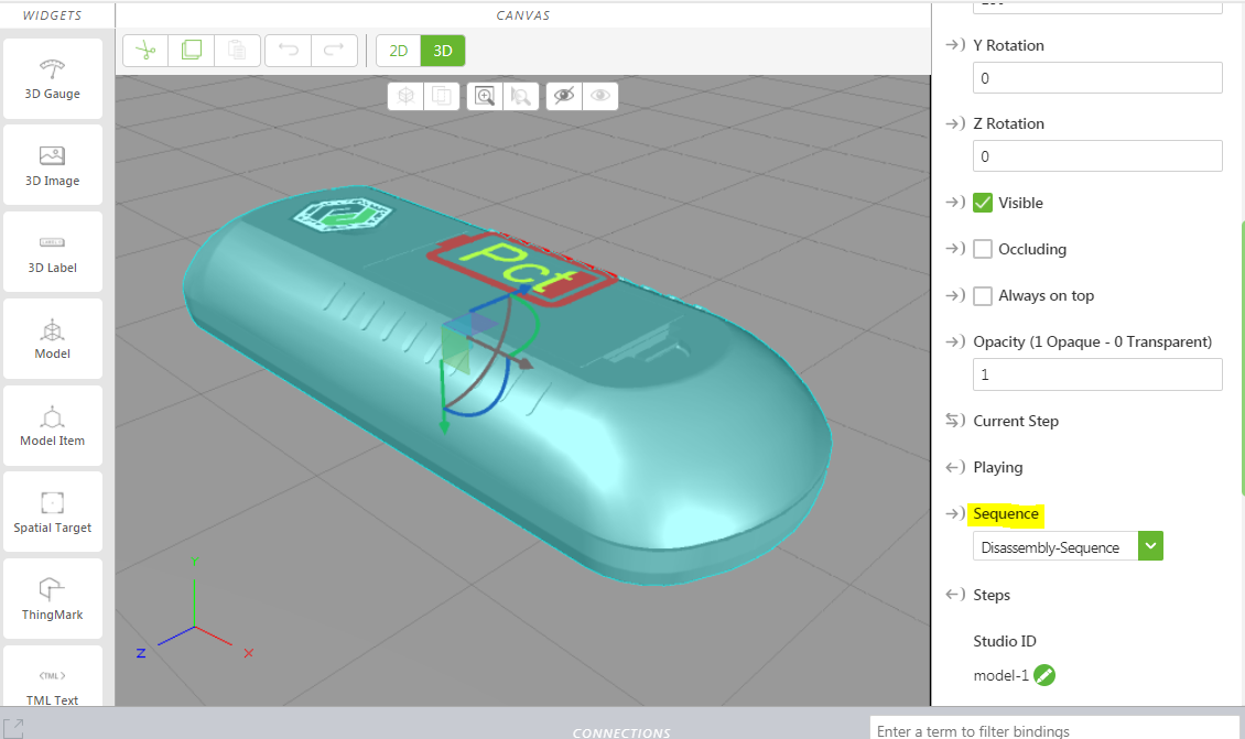

Nov 9, 2017 2:40 PM UTC
Hi Alperen,
Please follow the below steps to add a sequence to the 3D model:
  • Extract PVI file from the resulting PVZ file.
  • The PVI file must be added as a separate resource into the project.
  • Once that PVI file is added as resource, we can select that PVI file from the dropdown list of Sequence property as shown below:
  • Now bind the click action of a button or toggle button to the 3D model components play service. If we toggle or press this play button it will then invoke the playback of that sequence service.
