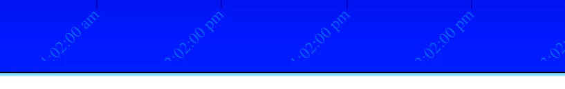

Hello everybody, i use a time series chart in studio but the data dont show complete in the screen (show the picture)
 How can i make the complete data look? or what can use in this case?

Are you using this widget within another container widget such as a grid widget or panel? If so, ensure that the size of the container widget is big enough to view the entire times series chart widget. You can also try using the 'margin' parameter to help add space around the widget.
