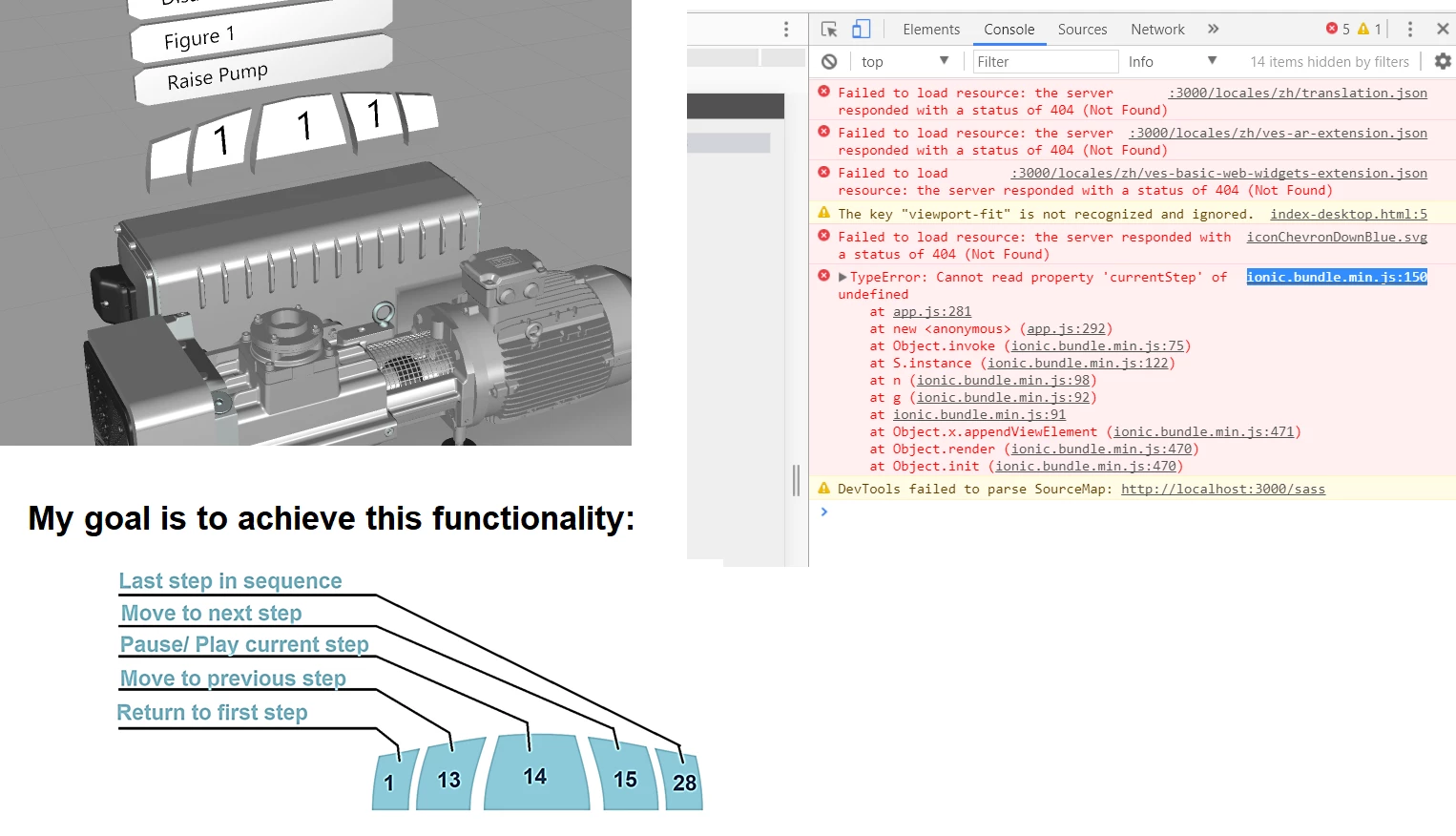

Show sequence step number on 3D label
How can I create logic to grab the currentStep of a sequence, subtract 1 and then bind it to a 3D label?
Each time I try this code (below), I get this error
"TypeError: Cannot read property 'currentStep' of ionic.bundle.min.js:150 undefined"
/// Indicate Numbers on Buttons
if($scope.app.view.Home.wdg.pump.currentStep === 'defined')
var p = $scope.app.view.Home.wdg.pump.currentStep+1;
var n = $scope.app.view.Home.wdg.pump.currentStep-1;
$scope.app.view.Home.wdg.prevNumber.text = p.toString();
$scope.app.view.Home.wdg.nextNumber.text = n.toString();
The model is "pump"
The Studio ID of the 3D labels are prevNumber & nextNumber (to indicate the steps before and after the current step). Please see attached image too.
[currentStep] I think is a number, and wdg.[3D label].text must be a string so this is why I'm trying to use "toString()"
Any ideas would be appreciated. Thanks so much!
-Wes

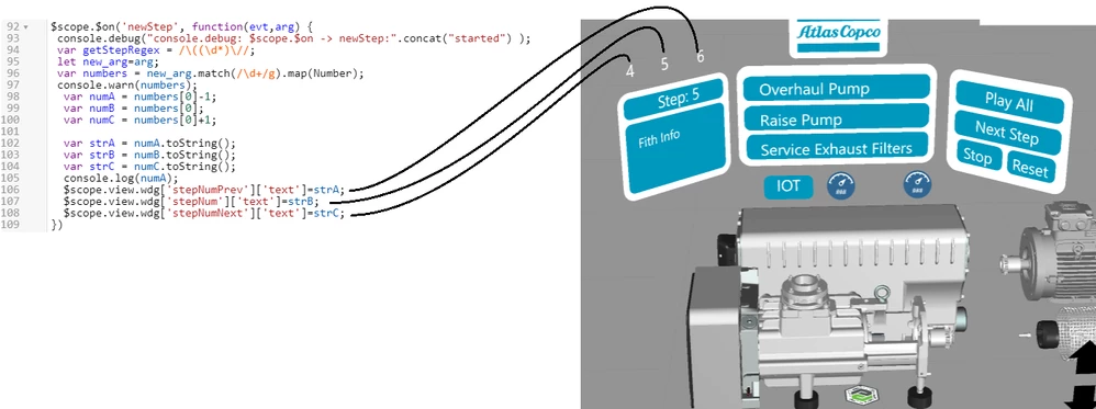

It took me awhile, but I finally got it.
// important code that I don't fully understand ;D
$scope.$on('newStep', function(evt,arg) {
var getStepRegex = /\((\d*)\//;
let new_arg=arg;
var numbers = new_arg.match(/\d+/g).map(Number);
// below is the math section I spoke about earlier. numbers[0] = current step
var numA = numbers[0]-1;
var numB = numbers[0];
var numC = numbers[0]+1;
// convert the numbers to strings so I can assign them to the 3D label "text" property
var strA = numA.toString();
var strB = numB.toString();
var strC = numC.toString();
// assign the strings I created to the 3D labels
$scope.view.wdg['stepNumPrev']['text']=strA;
$scope.view.wdg['stepNum']['text']=strB;
$scope.view.wdg['stepNumNext']['text']=strC;
// IT WORKS!
The next step for me personally is to add something behind each number with a clickable functionality -- (go back a step; pause/play; and go forward a step).
This also lays the groundwork for some other powerful features such as showing an image associated with the previous step, current step & next step -- and to have these images change dynamically depending on the current step.
Thanks Roland!
Wes

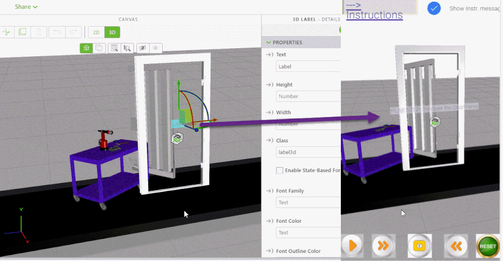

Hi @Wes_Tomer,
I think the best way is to use one of the events for steps.
Newstep or stepstarted or stepcompleted as was mentioned in the post:
https://community.ptc.com/t5/Studio/List-of-all-throw-events-in-Experience-Lifecycle/td-p/597270
I think I have an example where I did similar task with "newStep" but need to find it first...
OK here the example where I used a model with a sequence and a 3d Label widget
Here the code for it - so it should change the lable when a new step is started. I added also there some comments to the  code to make it more clear (I hope Man Happy )
//sequnece
//array with the steps what should be played here
// it could contains any string for a particular step number
// we could assess it via the stepnumber
// e.g. stepArray[step]
$scope.message = 0;
var stepArray = ['0-Start Step',
 '1-DoorLock installation',
 '2-mount the DoorFrame',
 '3-Assemble the Isolation',
 '4-Assemble the Door panel',
 '5-Assembly the Door Handles',
 '6-Check the Door Mechanism and clean',
 'step 6',
 'step 7'];
 console.debug("console.debug: $scope.$on -> newStep:".concat("started") );
 // this expression getStepRegex.exec(arg)[1] - returns the step number 1,2 ... etc.
 $scope.message = getStepRegex.exec(arg)[1];
 //print info about the message to the console
 console.info('message='+$scope.message);
//this message object will convert the number by assigneeing to property
// it will convert to the message
Object.defineProperty($scope, 'message', {
 get: function () { return _message; },
 set: function (step) {
 if(stepArray[step]) {
 _message = 'PLAY STEP: ' + stepArray[step];
 } else {
 _message = "Something going wrong- retry,please!";
//set the 3d Widget lable to the message
 $scope.view.wdg['3DLabel-2']['text'] = _message;
April 17, 2019
- the provided example above was tested on Preview and on adroid device - there was working fine.
Additionally , please see the last 3 comments from ClayHelberg about enddevice compatibility  (IOS)  in the post
https://community.ptc.com/t5/Studio-Tech-Tips/Display-sequence-step-names-from-Creo-Illustrate/td-p/534911/page/3
