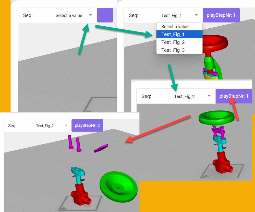

Hello, the title is self explainatory: I have uploaded a pvz file in a Vuforia Studio experience with some sequences contained in the sequences dropdown menu of the model and I would like to show such values in a select widget. The sequences in question are those present in the attachments (which are figures in creo illustrate). It seems such a stupid thing but I'm kind of stuck in it so I wanted to know more about it.

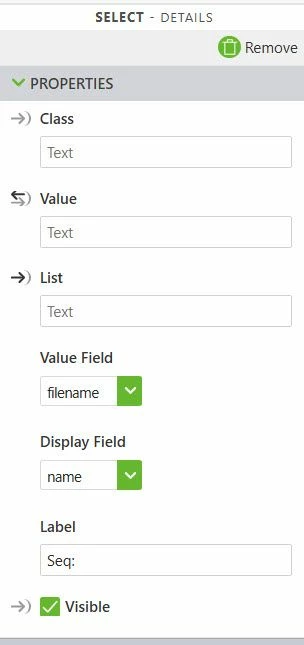

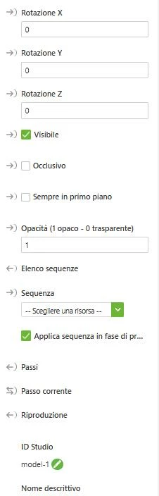

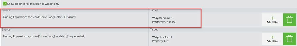

1.) steps link /bind the property of the model sequnece List to the select widget list property
2.) then in the select  display Filed = name and Value Field = filename
3.) last is to bind the value property of the select widget to the sequence property of the model
that is all. Please, let me know if that answer your question! Thanks

Hello @RolandRaytchev, I already figured out a solution but the material you provided will be very useful so thank you very much
