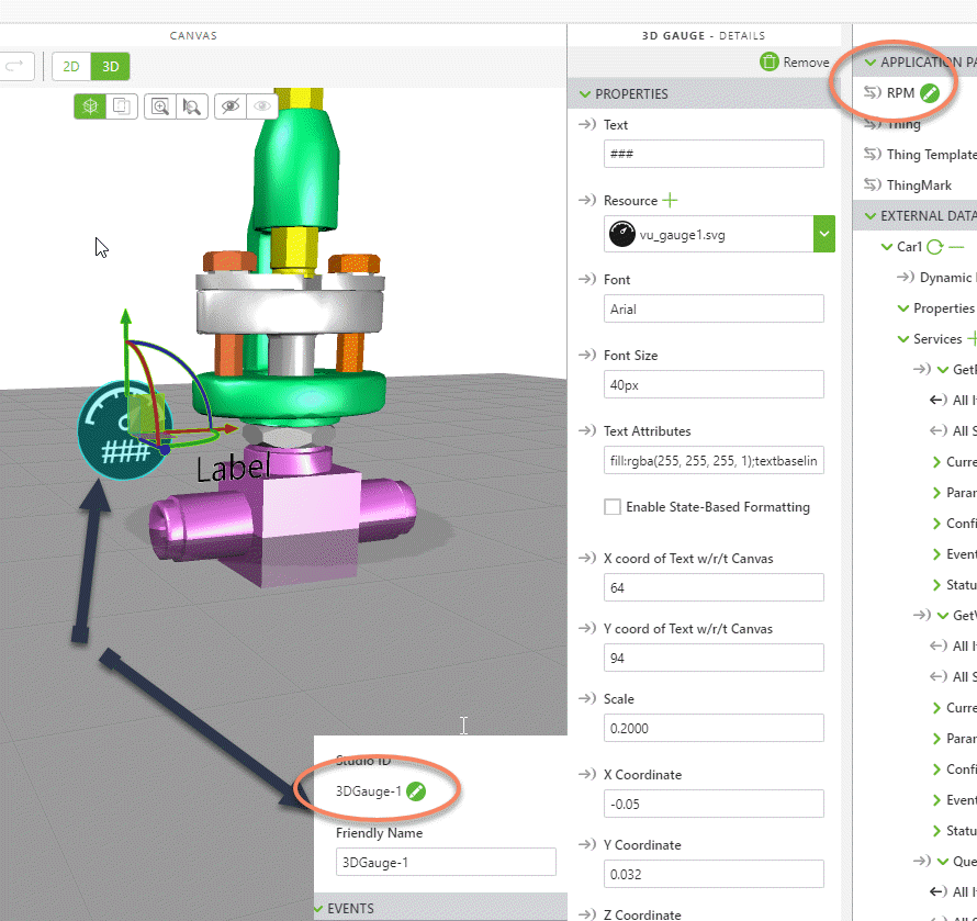

here a very simple example simulating a value:
So following demo project :
In this project I have a 3D gauge "3DGauge-1" and application parameter RPM
Then added the following script:

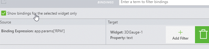

The $watch construct will bind the value to the gauge text property. Of course, you can use direct binding from application parameter "RPM" to 3DGauge-1 .text. In this case the $watch construct is not required e.g:
