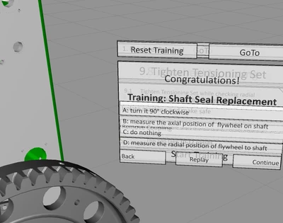

Since update i can click on invisible widgets which is not wanted
Hello
My scenario is build up in a way that there are a lot of 3D-Images-Widgets and in Javascript I control when which Image is visible in order to go step by step through a training. In some of these widgets I implemented Click-Events with functions so they act like buttons.
It was running very nice but since I updated to Version 8.5.7.4613 I can't click the buttons always because the ones which are invisible are still clickable which results in a mess. It's because some buttons are on the exact same place and when I click on the button you have some chance to click the correct visible button but mostly it clicks on one which is invisible and should not be clicked.
Can I somehow deactivate these Widgets totally?
Or is it maybe a bug because it was running before the update?
Thank you for any help.
Best regards
David

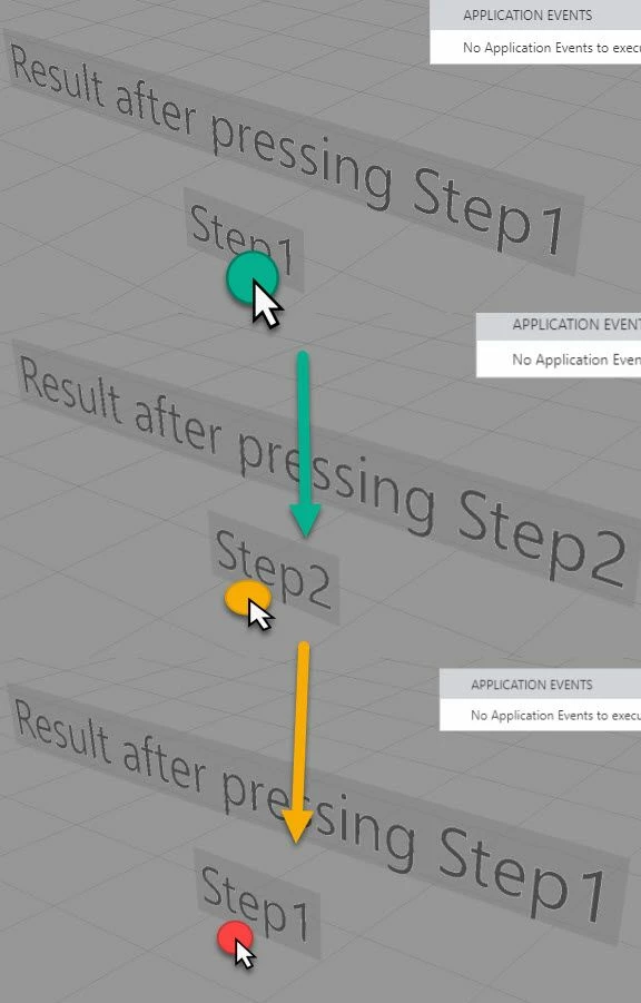

Hi @RolandRaytchev
Thanks for your reply.
Regarding the 'disable' property I can't disable the 3D-Images.. Is this even possible because in the Widget-Properties I don't see this property? I also tested the command $scope.setWidgetProp('test','disable','true'); but it didn't help.
I prepared a simple example and made a ZIP file out of the project from "..\Documents\VuforiaStudio\Projects" and attached it. Can you work with that?
In the simple example I have 2 buttons on the same place. If you click on the visible start button, the invisible second button gets executed..
Thanks for your help.

Hi @BCAG_David ,
yes, could reproduce the problem , -boo definitely -not good!  ☹️
No idea how such problem could occur- means issue occurs also when we register listener in JS .Needed some time to find workaround. Currently the only workaround, I found after some checks,  is to move the element in z direction - example:
$scope.app.myElements =
 {"grp1":["3DLabel-1","3DLabel-3"]},
 {"grp2":["3DLabel-2","3DLabel-4"]}
$scope.buttonStep1 = function () {
 console.warn("buttonStep1 was executed!");
$timeout(()=> {
$scope.app.setVisObj($scope.app.myElements,"grp1",false, 0.1)
$scope.app.setVisObj($scope.app.myElements,"grp2",true , 0.1)
 $scope.$applyAsync();},100)
$scope.buttonStep2 = function () {
 console.warn("buttonStep2 was executed!");
 $timeout(()=> {
$scope.app.setVisObj($scope.app.myElements,"grp1",true ,0.1)
$scope.app.setVisObj($scope.app.myElements,"grp2",false,0.1)
$scope.$on('$ionicView.afterEnter', function() {
$scope.userpickDef('twx-dt-label')
$scope.userpickDefGen() //second defintion
 $timeout(()=> {
$scope.app.setVisObj($scope.app.myElements,"grp1",true ,0)
$scope.app.setVisObj = function(objs,grp,vis,val) {
for(i in objs)
 for(j in objs[i][grp]){
 let wdgName = objs[i][grp][j];
 $scope.setWidgetProp(wdgName,'visible', vis);
 if(!vis)
 $scope.setWidgetProp(wdgName,'z',$scope.view.wdg[wdgName]['z']- val);
 else
 $scope.setWidgetProp(wdgName,'z',$scope.view.wdg[wdgName]['z']+ val);
 console.info("=>wdg:"+wdgName+" ["+i+"]["+grp+"]["+j+"]=>vis="
 +vis+" val="+val +" z="+$scope.view.wdg[wdgName]['z'])
It is important that this Issue should be reported to PTC dev team  but a fix will need some time , at least until the next release.
