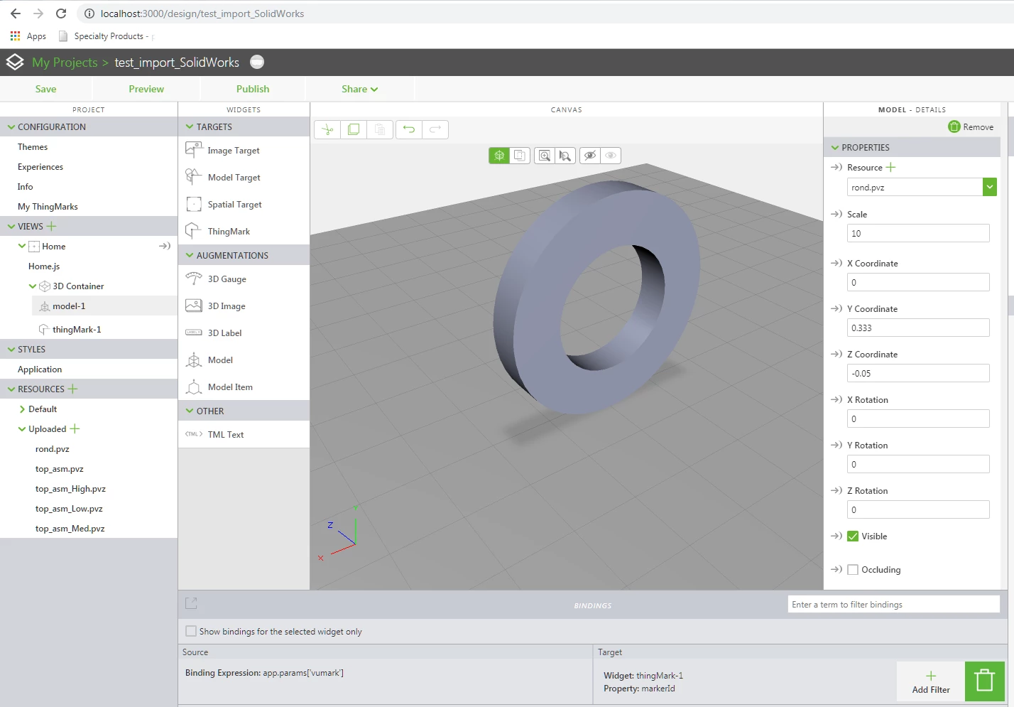

I have checked a simple Assembly model with 2 Components made in SolidWorks 2017.
Importing Assembly is working but no 3D model is visible in the 3D View.
in Creo View when opening the pvz file generated in the Project folder, %USER%\Documents\VuforiaStudio\Projects\"My test project name"\src\phone\resources\Uploaded
No 3D data is visible also.
I don't have this problem when importing sldpart files.
