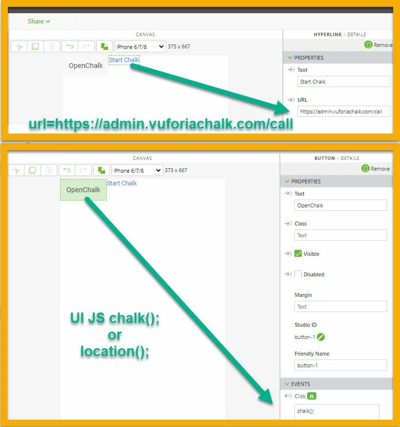

Hi Community,
I am wondering if would be possible to start Vuforia Chalk App from a Studio 2D Experience like we can do using the Chalk button on 3D Experiences.
I know there is no widget for that but maybe someone can point me to a way to start an app using realwear API from JavaScript.
Any ideas are welcome.
Thanks in advance,
Felipe Duarte

Hi @fbdsilva
we do not have extra chalk widget but calling of chalk in 2d widget but it should work also from Hyperlink widget and also via JavaScript code
So to work this is required:
- chalk is installed on the mobile platform
- I think the first time when you start chalk from Vuforia View  it will request permissions for starting chalk
- this will not work in Preview mode - only on mobile device
Here in the picture  below - there  are shown 2 ways - 1.) hyperlink widget via URL (url=https://admin.vuforiachalk.com/call)
or 2.)  form  button calling js code (it could be any widget supporting UI JS box on click or other actions)
where in US UI  you can use e.g. one of the following js code chalk() or location() - I tested both on IOS  device Ipad and  they are working fine.
/////////////////////////////////////////////////// this will not has effect on IOS
$scope.chalk = function ( ) {
 console.log('call https://admin.vuforiachalk.com/call' );
 try{
 	window.location.href='https://admin.vuforiachalk.com/call';
 twx.app.fn.addSnackbarMessage("window.location.href="+window.location.href,"twLogo");
 catch(e)
 alert('call failed ' + e);
//or
$scope.location = function () {
 try{
 $timeout( () => {var ref = window.location='https://admin.vuforiachalk.com/call' ;
 twx.app.fn.addSnackbarMessage("window.location="+ref,"twLogo");},500)
 catch(e)
 alert('chalk location failed ' + e);

Mar 29, 2021 7:28 PM UTC
That´s perfect. It was exactly what I was looking for.
Many thanks!
