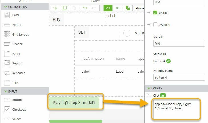

I have created three figures in Creo model. Figure 1 has three steps. So I want to bind the steps with different buttons. Example, step-1 button have to play, step-1 sequence. Same way step 2 button have to play step-2 sequence.
How to do this.

Hi @RK_9880418 ,
you can try  to use a javascript some definition like this
//definition of the function
$scope.app.playModelStep = function (sequence,modelName,step_number,play) {
//sequnece -sequnece name e.g. TestFigure1 - as shown in UI
//modelName - model name e.g. model-1
//step_number - set this number to current step
//play true/false execute play for the model
$scope.$applyAsync(()=>{$scope.setWidgetProp(modelName, 'sequence', '');});
 $timeout(function () {
 $scope.$applyAsync(()=>{$scope.setWidgetProp(modelName, 'sequence', 'app/resources/Uploaded/l-Creo 3D - '+sequence +'.pvi');});
 },50);
 $scope.$applyAsync(()=>{$scope.setWidgetProp(modelName, 'currentStep', parseInt(step_number));});
 if(play) //check if play should be applyed
 $timeout(function () {angular.element(document.getElementById(modelName)).scope().play(); }, 100);
 }, 500);
so you can play it  e.g. for  Figure 1 in model-1 widget and step 3 via the call
$scope.app.playModelStep("Figure 1","model-1",3,true)
So can define a extra callback for each  step or use the statment directly in the UI

you need to bind 2 button with js
suppose for a Button 1 u need to bind it with model (Play all / play) and simultaneously need to right js code for sequence to play and similarly for button 2 also
Jul 7, 2021 6:29 AM UTC
With the code
$scope.playSpecificStep = function(step){
 $scope.view.wdg['model'].currentStep = step;
 $timeout(()=> twx.app.fn.triggerWidgetService("model", 'play'), 100)
For PlayButton1, Click JS: playSpecificStep(1)
For PlayButton2, Click JS: playSpecificStep(2)
