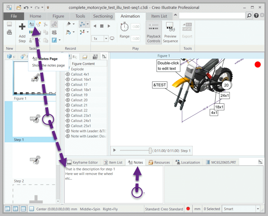

I created sequence in Creo Illustrate with some notes & I want to show that description at every step.
I bind model property (steps) to Lable but it's showing no. of steps. How can I show that notes in studio.

Hi @Swapnil_More ,
I think you mention the description info and you meant the note page as shown on the picutre above - here I want to make it clear:
In the current functionality the info of this  note will be not passed to  Studio and we can not used it directly in Studio widget  yet. So far I know there are an enhancement requested  but it is not implmented yet or I do not have info about such implementation

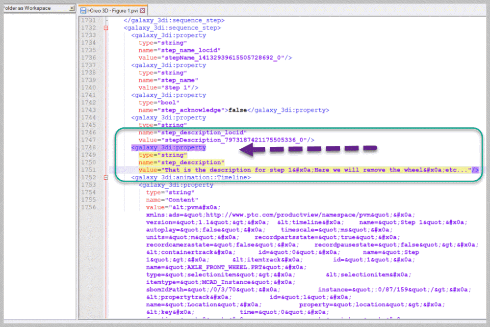

When we check the pvz file -> rename it as zip file and then extract - then we can find in the sequence file *.pvi - the desired informaiton - as shown here in example:
So the *.pvi file has an xml style so you can easy extact this info using some script. So you can define  form there an jason or other array which contains the information and later could be pasted in studio project  and used for setting some widget properies  when a step is played. Such techniques was  already described in the post "Display sequence step names from Creo Illustrate"
