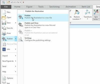

1- publish the sequence as a .pvz

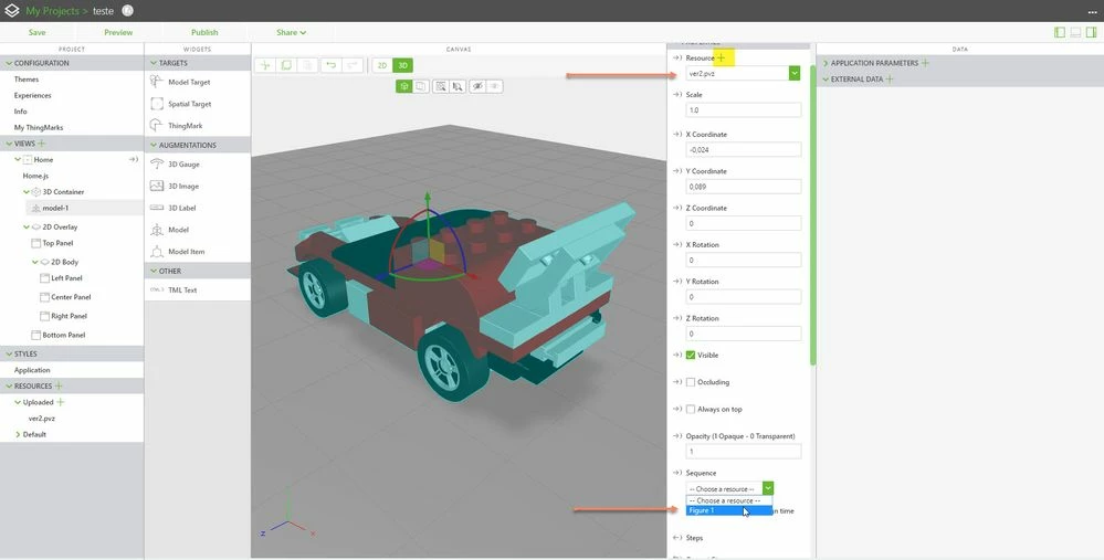

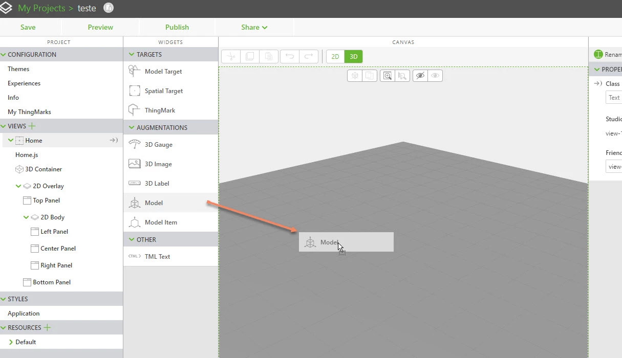

2- at the vuforia studio you just need to drag a a 3d model to scene:
3- Select the .pvz you've saved as the model resource, and select the sequence at the  sequence attribute.

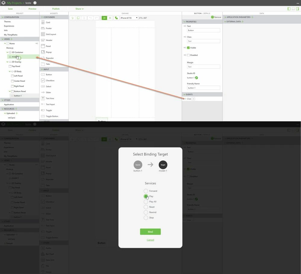

At last, you just have to create a kind of button in the 2d layer and bind the click to the model PLAY service:
Done.
