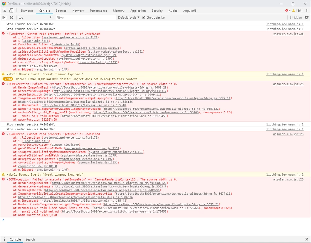

In 8.3.3 i have noticed that i frequently see what ;look like crash and restarts of the Studio render engine when placing ModelItems (dropping the widget onto 3D). It will create the item and then a second later 3D window will go blank and then rebuild from scratch over the course of 5-10 seconds. Beyond the interruption in work flow, after this happens selection highlighting of modelItems stops working.
Here is what i see on the console when this happens

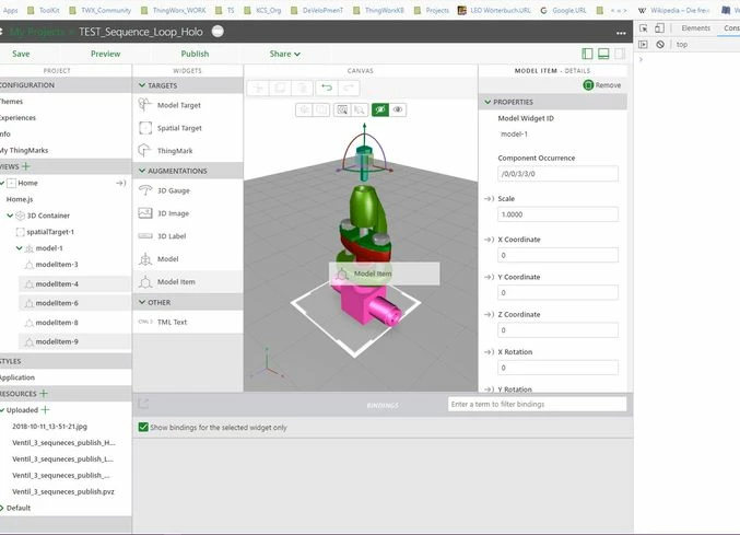

I used the Studio current version 8.3.5 and a simple model with 10-15 components coming from Creo Parametric - exported to pvz file.
I did with drag and drop some modelitems but no errors. (I did it in this simple model , repeat this action many times=

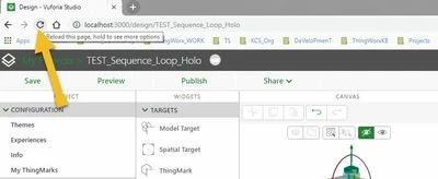

2.) regarding to loss of the highlighting functionality.  I could remember that some time also this effect that windows is blank and need to refresh . But when I reload the browser windows then it seems to work ok. So my question, if you did in the browser an explicit reload .  Does the issue after reload of the browser windows  still exist?
