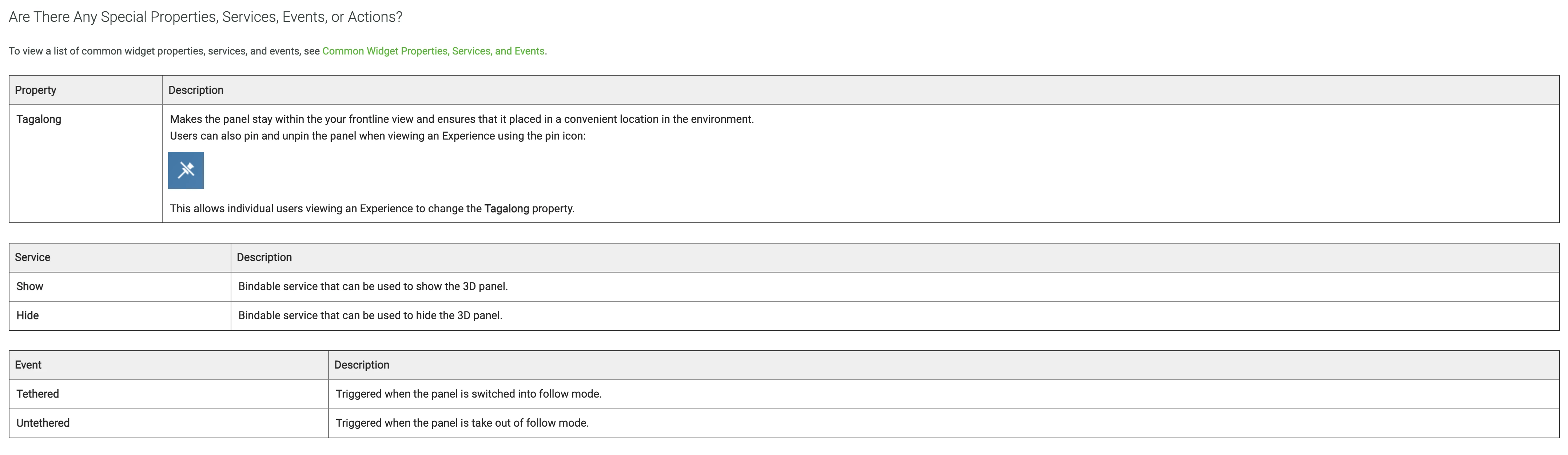

Per the help center here. there is a supported show/hide service to control the visibility of the widget. I don't see the service available in my design time properties panel for the widget, but I can make a call to that service using: twx.app.fn.triggerStudioEvent(document.querySelector('[widget-id="3DPanel-#"]'), 'app.view["Home"].wdg["3DPanel-#"].svc.hide');
This seems to work intermittently at best for my particular implementation.

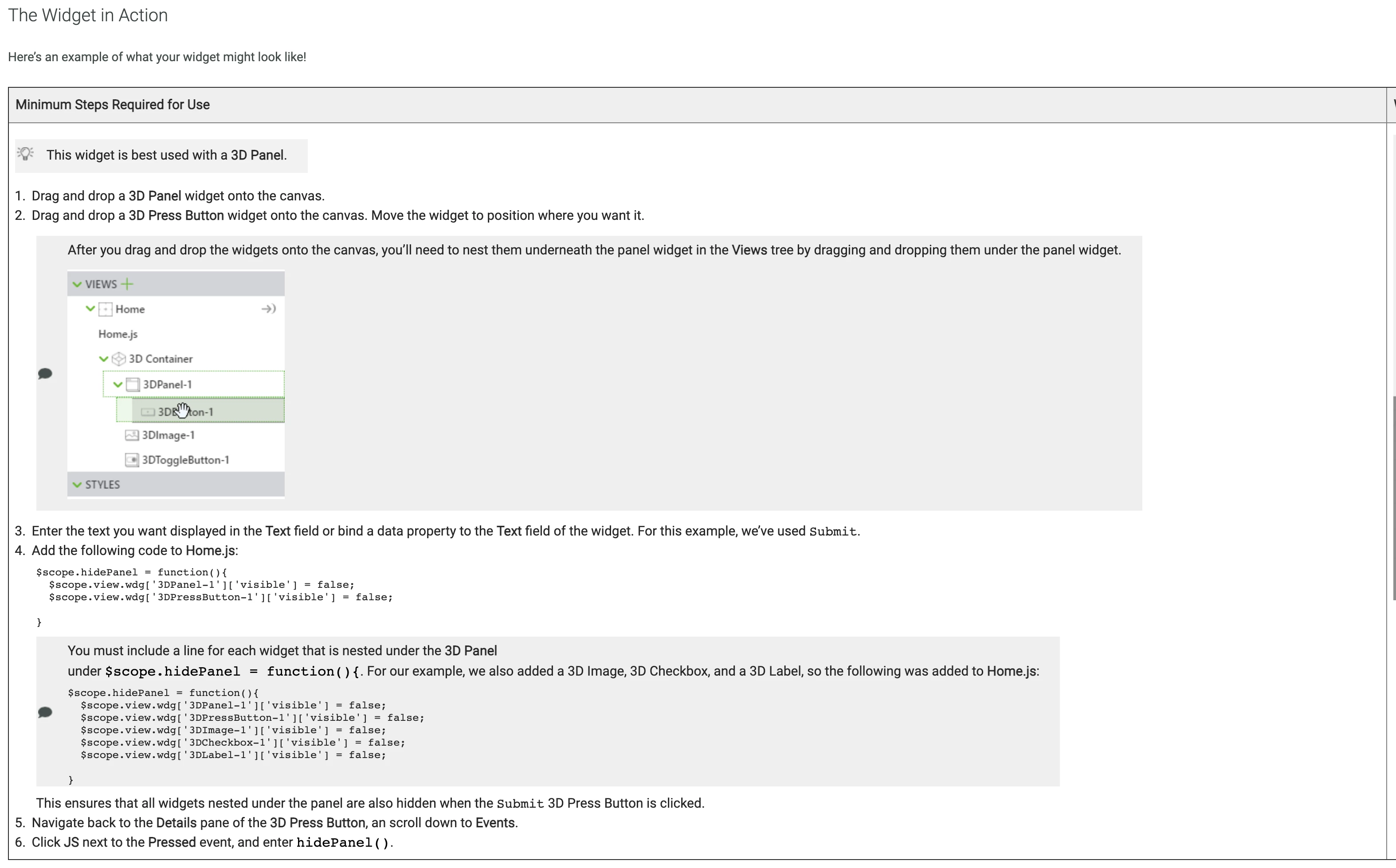

However when I browsed for the documentation in the 3D Press button, it seems that the supported practice is to use standard widget notation to show/hide using the visible property of the panel as well as all of its contained widgets.
Using this method I have had better success than just calling the service. When I call the service AND then hide the panel and all the contained widgets, the result is much more reliable. I have a significant amount of widgets on the panel, so that may be affecting the usage.

hi @Aouellets
We had a slight error in our documentation and are updating it accordingly. You should use the 'visible' property to show/hide the 3D panel.

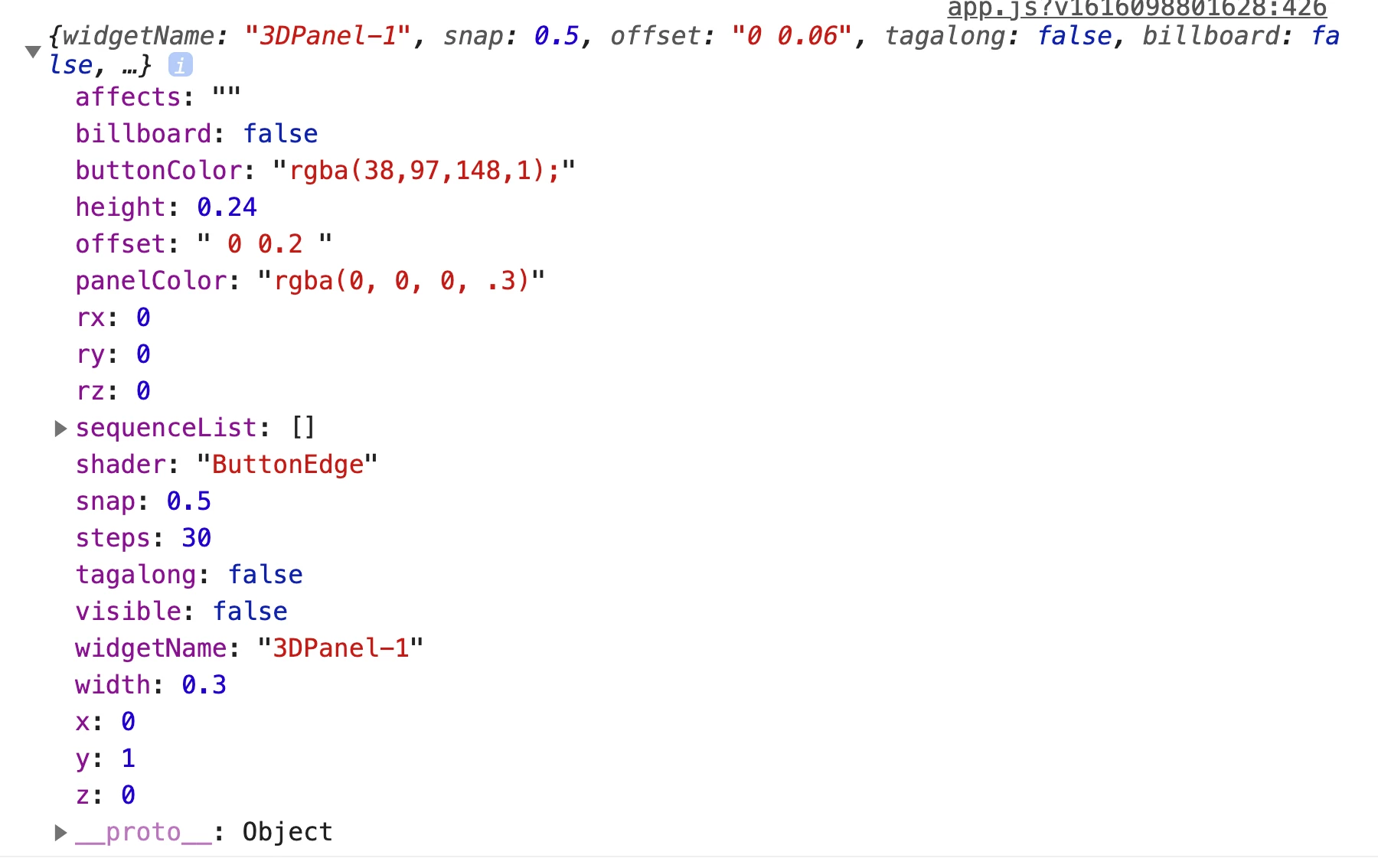

Additionally if you happen to know the answer:
For the offset property of the 3D Panel widget, the property seems stuck at 0 0.06 and I am unable to effectively change that value. The issue is, for me, when in the tagalong state I cannot reach the panel.
I've tried updating the value several ways, and each time even if the value is printing correctly in the console it is still out of reach.
Any thoughts on this?
