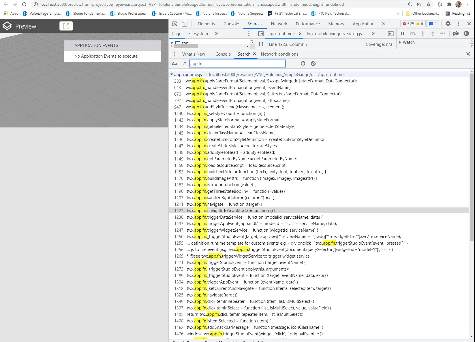

Possibility to recall the vuforia view system commands on Hololens 2 avoiding the voice commands.
This method is useful for taking advantage of vuforia view in noisy environments.
I could only find the navigateToScanMode () command on the network;
$ scope.go = function () {
   $ scope.app.fn.navigateToScanMode ();
Is it possible to have a list of all the following?:

There may not be equivalents I would need to explore but I wonder if you have tried  in preview mode using use control shift i (windows) to open the source and then search in your case ,app.fn - see image  there you will see twx.app.fn.navigateToScanMode
Jan 11, 2022 6:36 PM UTC
Interesting but I don't find anything about the other commands ...
We should look for where he receives the "Hey View" command on a vocal level there will certainly be a "speech to text" service, here I should find the commands... Maybe
