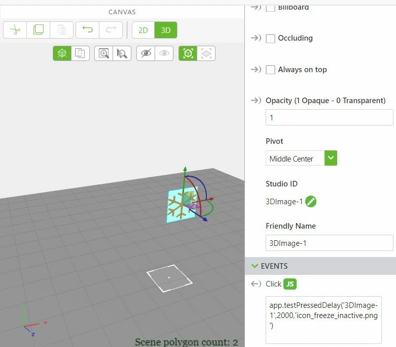

I think there could be different approaches to   implement the requested functionality . Here I want to provide one possible option:
  • supposing you want to use 3DImage widget on mobile Vuforia Studio Project. So we use there the click event
  •  where the function will have as arguments the 3DImage widget name, the delay -2000ms - 2 seconds and the name of the picture what is inactive. the pictures file should be uploaded to the Project Upload folder
    app.testPressedDelay('3DImage-1',2000,'icon_freeze_inactive.png')​​
    The code for the call will be added to the UI click box of the 3DImage widget - here it is the 3DImage-1
  • It is important to block the action of the function during of the execution - 2 second . this could be done by global variable:
$scope.app.blocked=false​
 where then in the function we will check something like
if($scope.app.blocked) return;
$scope.app.blocked=true
  • at the end the complete code of that option  could be something like this:
    //call from click event of the 3DImage
    //app.testPressedDelay('3DImage-1',2000,'icon_freeze_inactive.png')
    //blocks the event when it is called for the delay
    $scope.app.testPressedDelay= (wdgName,delay,pressedPic) => {
     let currentPicture = $scope.getWidgetProp(wdgName,'src')
     $scope.setWidgetProp(wdgName,'src',"app/resources/Uploaded/"+pressedPic)
     $scope.$applyAsync();
     setTimeout( (wdgName,pic)=> { try{
     $scope.setWidgetProp(wdgName,'src',pic)
     console.info("delay ="+delay+" > wdgName: "+wdgName+" to "+pic)
     } catch(e){ console.error("outer",e);} },delay, wdgName,currentPicture)
I attached also a simple demo project to this post
