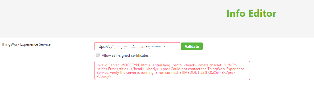

Hi ,
     when i try to validate my ThingWorx Experience Service , it gives me following error
     Invalid Server: <!DOCTYPE html> <html lang="en"> <head> <meta charset="utf-8"> <title>Error</title> </head> <body> <pre>Could not contact the ThingWorx Experience Service, verify the server is running. Error: tunneling socket could not be established, cause=connect ECONNREFUSED 127.0.0.1:80</pre> </body>

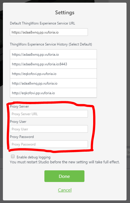

Hi, qadir
Maybe you can empty these, then have a try with a public network.
March 24, 2017
Look at the IP of the end, it has been changed. It means it's accessing an outside server now.
So maybe you are using a inside/private network, or you choose a proxy server in your IE LAN setting.
I faced these problems before. Because my company's firewall doesn't allow my access.First, I empty those in my ThingWorx Studio. Then I don't choose the proxy server in IE setting. Finally, I link to a public WIFI from my outside wireless network card. Now, it can works normally.
Therefore, maybe you should link to a public network, such as a public WIFI, or other networks outside of your company.
Wish these can help you.
Apollo

I have tried it in open network . it is working fine.
