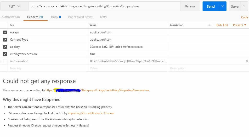

I hope this post brings me with positive solution.
I have installed Studio server locally, and reaching out to my composer UI using: xxxxxx.studio-trial.thingworx.io:8443/Thingworx/Composer/index.html#
and I am using the thingworx IoT foundation composition from the server launch remotely: https://pp-xxxxxxxxxx.devportal.ptc.io/Thingworx/Composer/index.html#
I am trying to get the data in the studio using the external data pane so that i can visualise the real time data,
I have tried all of the solutions provided:
1. Tried doing federation configuration taking my Studio local server as Source system and IoT server as Target system and vice-versa but after checking with monitoring tool; these servers are not getting published or subscribed.
2. Tried connecting with POSTMAN; the PUT request works fine with the IoT foundation server but still error with the studio local server.
3. Tried connecting with NodeRed, using the Red Thing, it connected with the IoT but still din get connected with the studio local server.
Plz help me solve this, I want connectivity to the studio server and IoT foundation platform so that I can pull data for 3D visualization.
Im attaching the postman error for the studio server..:

Hi @nishad1092,
Could you please confirm if you are trying to establish communication between Studio ThingWorx Composer: xxxxxx.studio-trial.thingworx.io:8443/Thingworx/Composer/index.html# and remote ThingWorx:  https://pp-xxxxxxxxxx.devportal.ptc.io/Thingworx/Composer/index.html#.
Apr 5, 2018 6:03 AM UTC
Yes, Im trying to communicate between studio (local) and foundation (remote) platform.
Apr 5, 2018 3:53 PM UTC
Thanks for the update! I have tried the federation setup with my local studio and remote ThingWorx instance and it is working as expected. Could you please review the steps given in the below thread and let me know if there are any issues or questions:
TWX Federation Setup Guide
