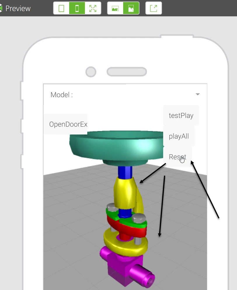

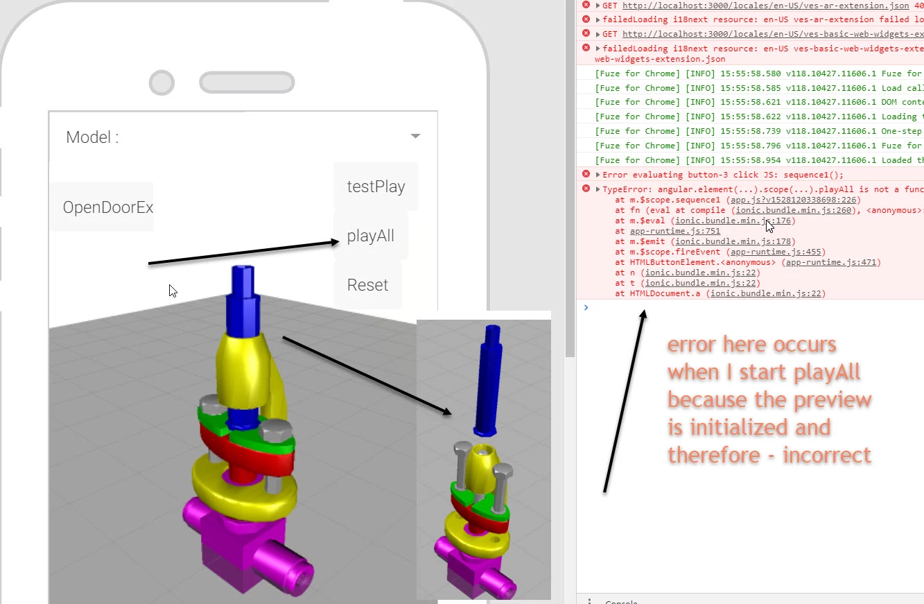

You can press Strg - Shift - I key to start the Chrome in debugging mode:
So in the console you can see what of error occurred. So for example I clicked the playAll button before the preview was not already initialized and therefore the error.
Clicking the Reset button here will call the function Reset1() which is working fine. e.g.:
So I used the following script code:
///////////////////////// used in button "playAll"
$scope.sequence1 = function() {
angular.element(document.getElementById('model-1')).scope().playAll();
////////////////////////// used in button _"Reset"
$scope.reset1 = function() {
angular.element(document.getElementById('model-1')).scope().reset();
