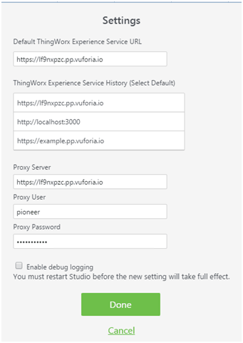

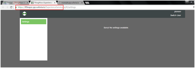

To register following information in Settings
It is accessible via browser with same account and password.
URL: https://lf9nxpzc.pp.vuforia.io/VuforiaExperienceService
Username: pioneer
Password: xxxxxxx

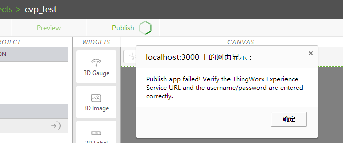

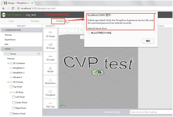

However, it reports following error when clicking Publish in Project.( the account and password is confirmed many times, so mannual input mistake can be ruled out.)

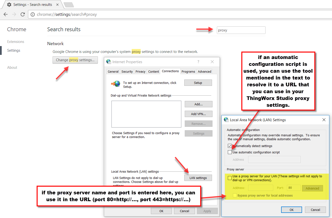

most likely your problem is related to your proxy settings. The URL that you entered for the proxy server is the same as the Thingworx Experience service URL. Instead you'll have to enter the URL of the proxy server that your company configured, most likely an in-house server.
There are multiple ways to figure out what this server is:
  • It can be part of your browser's configuration. You can get there from Chrome's settings dialog:
  • If a config script is used, follow this document to get the resolved URL of your proxy server.
I hope this helps, moritz

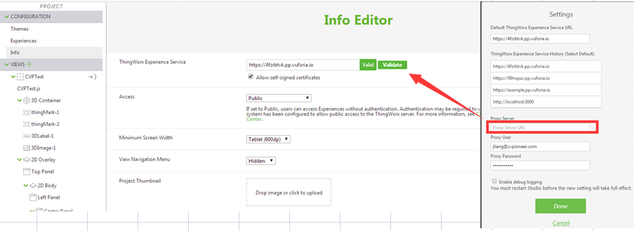

     If Settings Proxy Server is empty, click "Valid" button in Info Editor, prompting Validate

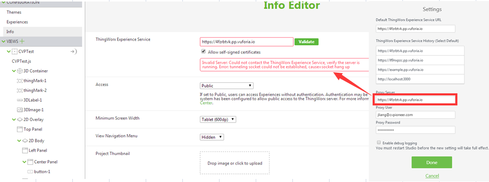

     If Settings Proxy Server is not empty, click "Valid" button in Info Editor, prompting: Invalid Server: Could not contact the ThingWorx Experience Service, verify the server is running. Error: tunneling socket could not be established, cause=socket hang up
     settings Proxy Server is empty, click the Publish button to wait for about 3 minutes prompted the following chart error

Yes, technically the proxy server shouldn't be the URL of the Experience Service, for the correct proxy I would strongly recommend either contact your IT team or follow the procedure laid out by Moritz.

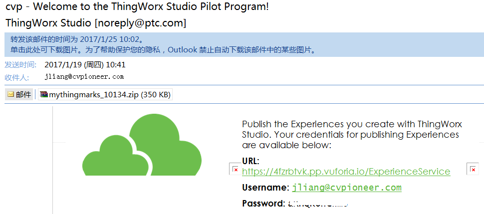

Now that without proxy, the validation is successful. From here on you can skip the proxy part. Coming to pop-up error, please verify your username and password, make sure you are using the credentials provided in the "welcome email" (not the ones you've created). Also try clearing browsing cache and give it a try.

   The user is using the credentials provided in the "welcome email".
