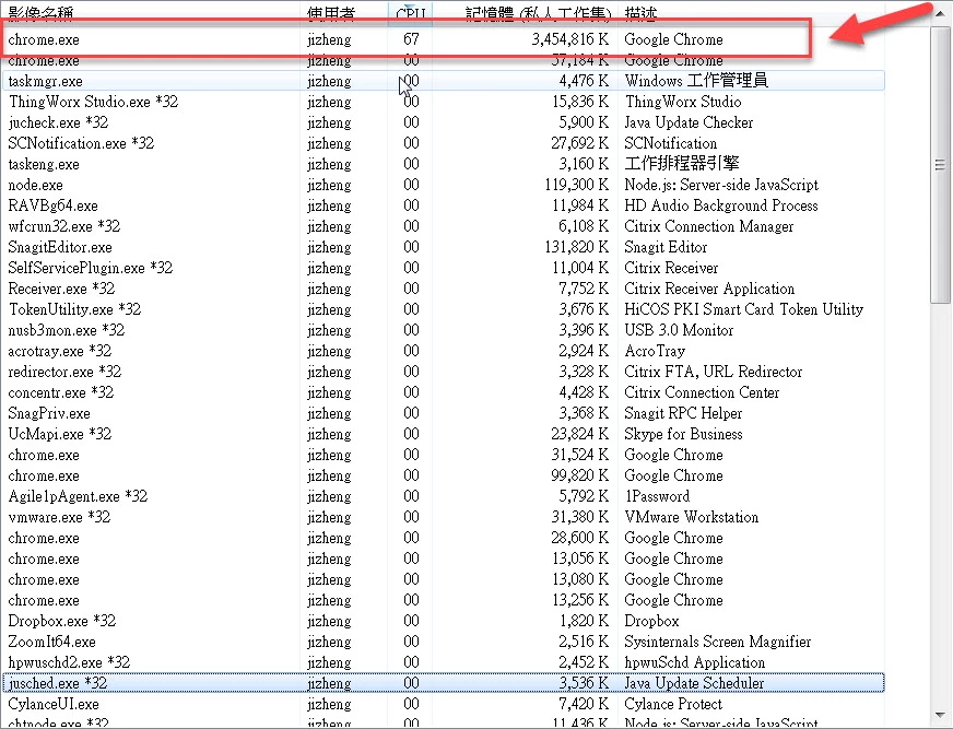

May 15, 2018 1:00 PM UTC
Hi Durgesh,
When I run the ThingWorx Studio in Chrome. The CPU usage is at 67%, and the memory usage is about 3.5GB.  TWX Studio does not work  properly, including rotation, zoom in and other actions.

Jun 4, 2018 12:09 PM UTC
Hello everybody,
I was able to have the same issues in ThingWorx Studio 8.2 last week.
Today, I have installed Vuforia Studio 8.3.
I am not able to reproduce the problems in my Projects.
I have worked on this subject on a case (I am a Technical Support Engineer in PTC).
This solution works also for the case owner.
I suppose that the root cause is due to rebranding name to ThingWorx to Vuforia.
At PTC, some URLs have been modified about that.
Can you have a try and come back in this thread, if you still have the issue ?

Jun 6, 2018 12:30 PM UTC
Updated to Vuforia Studio 8.3: stability seems to have been improved (haven't tested it much)
Auto update is disabled, so you must download it yourself on https://studio.vuforia.com/home/ and uninstall previous version
