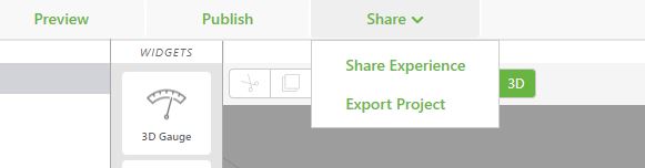

ThingworxStudio Share ?
i'm sorry my English isn't that good
we need to know how to use Share > Experience URL
and
Export Project > file xxx.json
we want to make MyARapp don't run on ThingWorx View
tmccombieAnswer
Nov 22, 2017 1:31 PM UTC
Hi Piyawat. Using the Share Experience option will give you a direct link to the Experience & the Export Project option will provide a zip folder of all project files. ThingWorx View is required to view experiences created within ThingWorx Studio.
