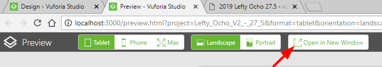

Jul 5, 2018 2:12 PM UTC
To expand on this with some info I got at Liveworx from a very helpful PTC person whose name i can't remember.
I often find I want to interrogate the values of stuff while previewing an experience to figure out why something is not working as expected. You can do this in a few steps in Chrome. First start your preview but then click the "Open in new window" button. This will get the preview out of the iframe making it simpler to access via the console.
Open in new window
After you have this open start he console Shift+Ctrl+i or 'three dots' > More tools > Developer Tools. In the console now you can type the following "window.twx", this will return a great object full of information.
  • The widget list Allan mentioned
    • appScope > view > [your view name] > wdg
    • can also list this directly with window.twx.appScope.view.[yourViewName].wdg
    • This displays the values of these objects at the time you hit enter in the console. You can poke around in your experience and then type this again to see if widget values are changing the way you expect.
