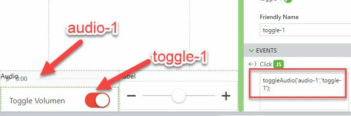

3.)you can define a function implementing the point 1 and 2 and set this function  to the toggle Wdiget UI JS Box change event:
The function definition could be something like this:
$scope.toggleAudio = function(nameAudio,nameToggle) {
 var myaudio = angular.element(document.querySelector('twx-widget[widget-id=\"'+nameAudio+'\"] audio'));
let toggle =! $scope.view.wdg[nameToggle].value
 myaudio[0].volume = toggle;
 $scope.$applyAsync()

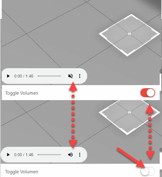

4.) Now when we test it - we will the desired behavior :
I attached a project example which demonstrates the issue /implements a demo solution
