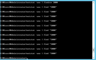

ello,
The exception in the log file is :
[2019-04-23T06:02:02.110Z] error: [twx-studio:index] uncaughtException { Error: listen EACCES: permission denied 127.0.0.1:3000
 at Server.setupListenHandle [as _listen2] (net.js:1253:19)
 at listenInCluster (net.js:1318:12)
 at GetAddrInfoReqWrap.doListen [as callback] (net.js:1451:7)
 at GetAddrInfoReqWrap.onlookup [as oncomplete] (dns.js:61:10)
 code: 'EACCES',
 errno: 'EACCES',
 syscall: 'listen',
 address: '127.0.0.1',
 port: 3000 } undefined
It is due that previous Vuforia Studio is still running or another application uses the port 3000.
Shutdown Vuforia Studio and software who are using this port 3000.

CHASEONHO18-OpalAuthor
18-Opal
Apr 25, 2019 9:10 AM UTC
3000 port is not in use and fails.
