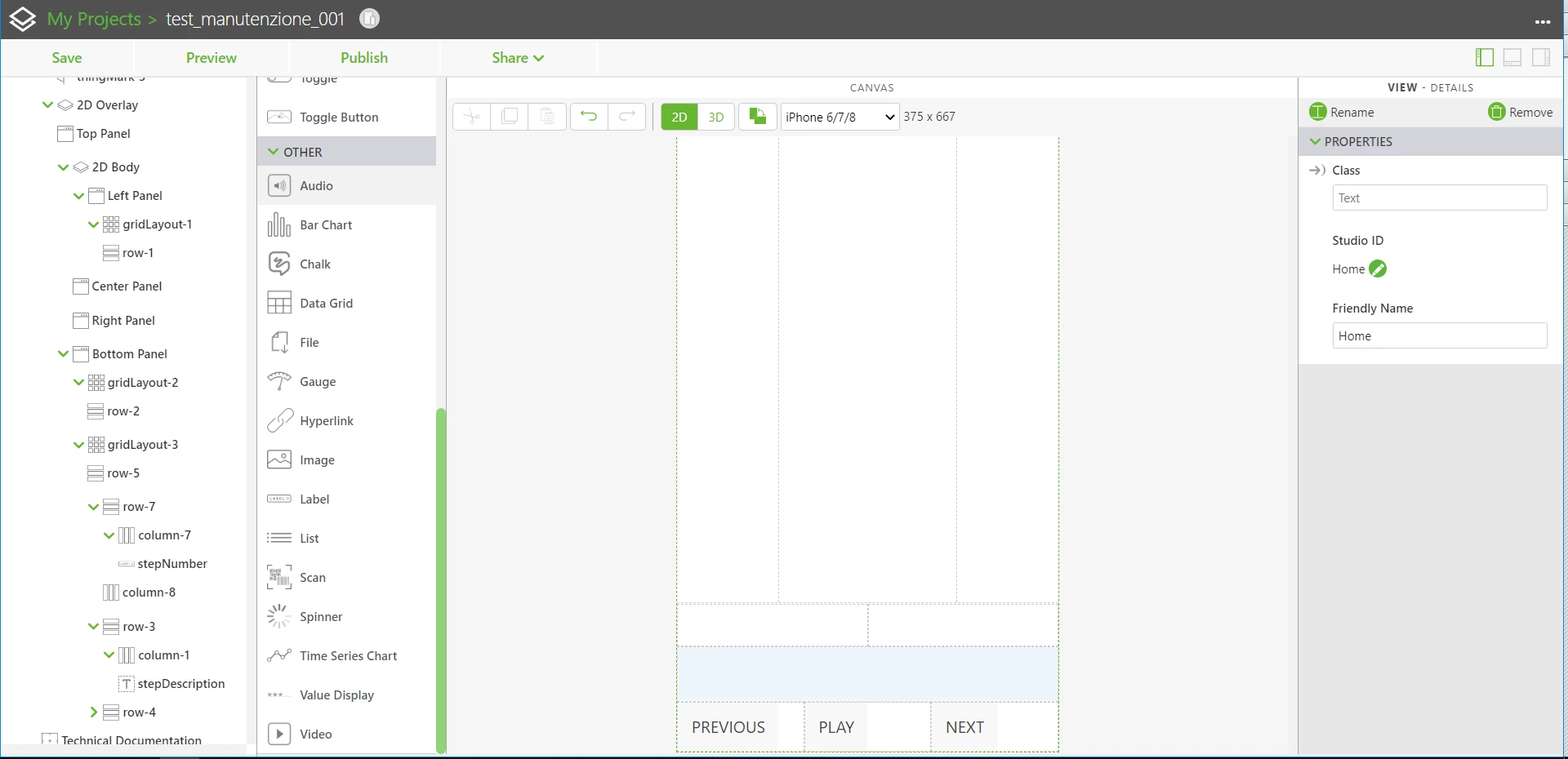

I want to share some tips about how play a sequence and retrive some information archived into pvz file.
1. In creo illustrate create your sequence with related step description;
2. in 2D canvas I put three bottons that when clicked fire a javascript call (e.g. sequencePlay(), sequenceNext()..) :
-play sequence
-next sequence
-previous sequence
3. For the visualization of step number I used a label (idStudio: stepNumber) and for the description a text area (idStudio: stepDescription).
The result is something like the image attached.
Into the javascript file copy past the folowing lines of code:
//modificare subito "Home"--> nome vista | "saldatura_trasversale"--> nome modello
$scope.app.percorso = 'app.view["Home"].wdg["saldatura_trasversale"]';
var labelDescription= 'stepDescription'
var labelStep = 'stepNumber'

 When you click into the play( or next or previous) buttons the relative function call $scope.updateLabel(). This one launch $scope.on("stepstarted") etc.. for print the stepNumber and stepDescription.
I hope it could be helpful.
