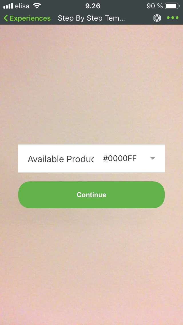

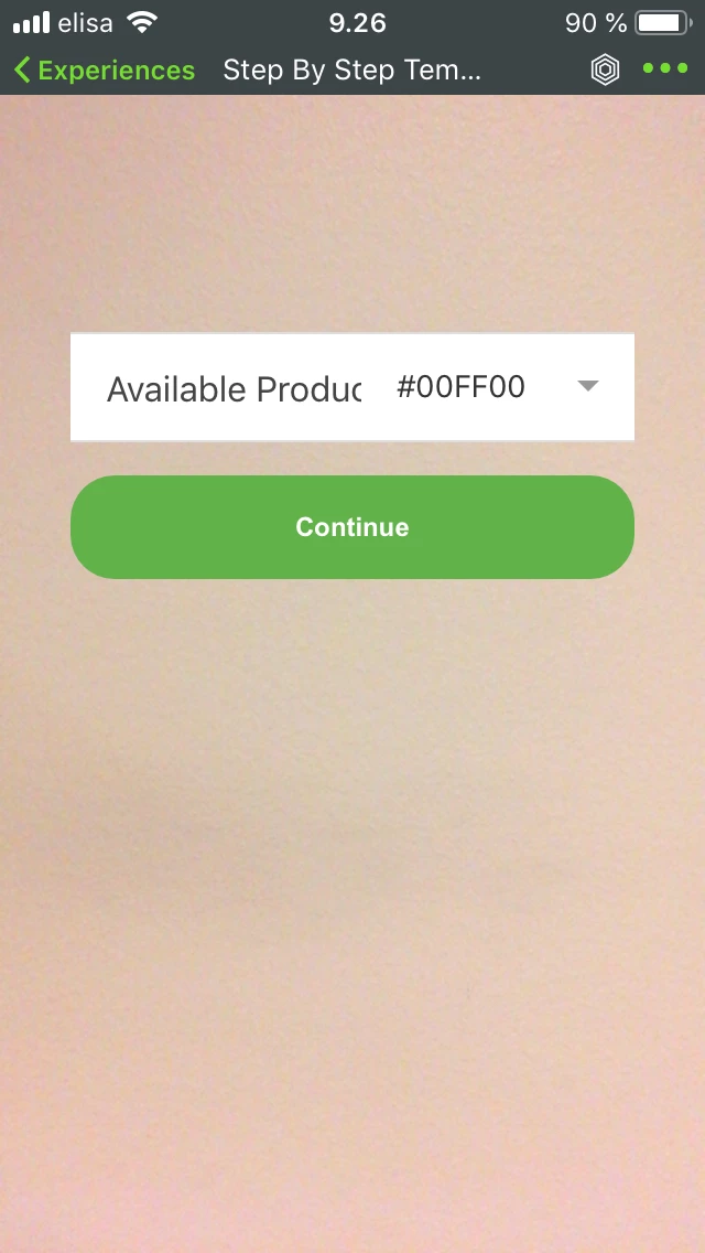

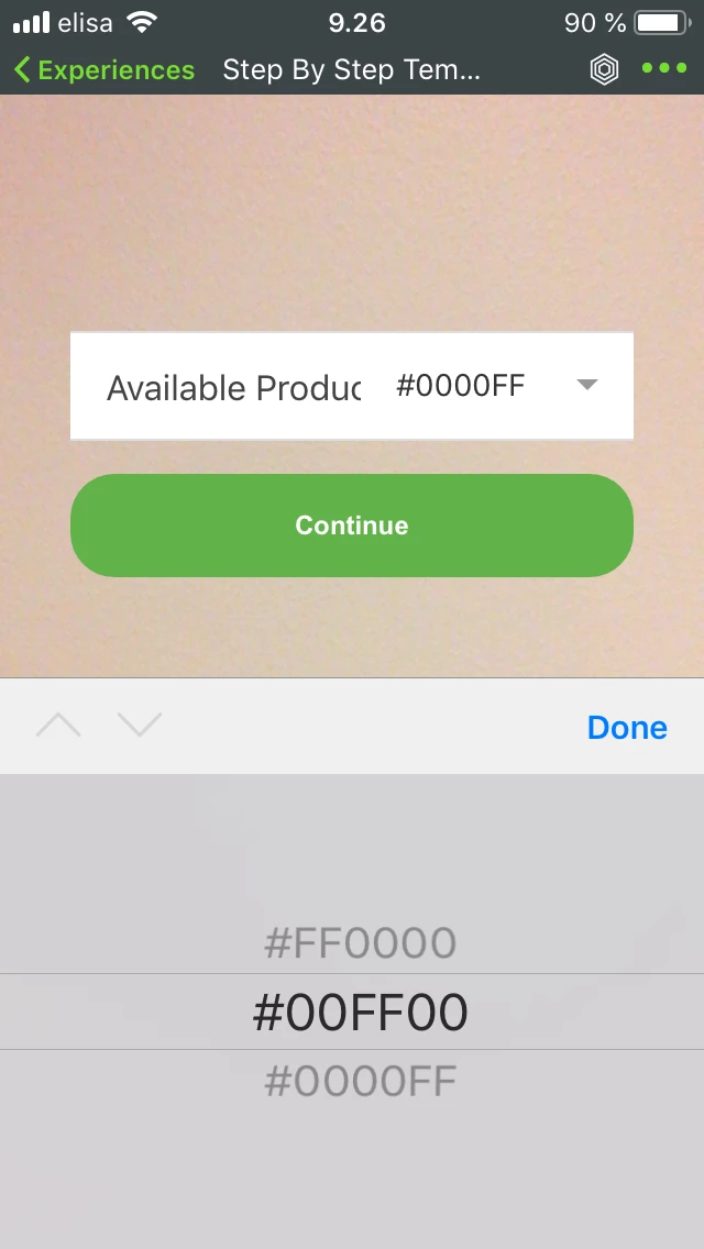

I have a strange behavior when using Select-component. In the middle of the screen I have a popup container with a Select- and Button-component. When I select the Select-component to choose one of the items in the list the UI moves upwards (To keep the component visible?), but when I'm done with the selection and closes it the UI remains in the upper position, it doesn't move back to it's original position. Not until I rotate the phone (UI is then re-drawn). Is it possible to force a re-draw with JavaScript?

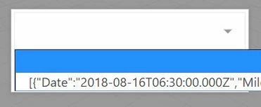

Also, is it possible to remove the label part from the Select-component? If I leave it blank it still occupies most of the width, I would like the value itself to occupy the whole width.
Can it be done with CSS?
