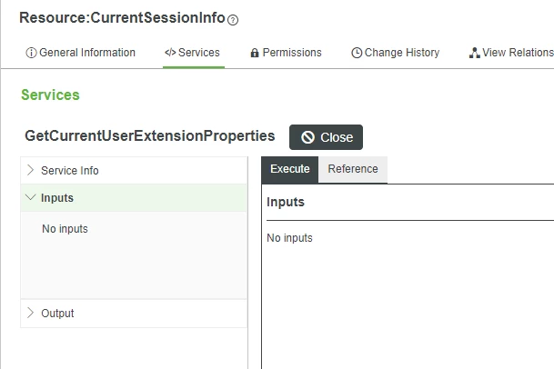

Unable to execute the service from thingworx to Vuforia Studio
Can anyone please look at it as i want to execute this service from RESOURCES in vuforia studio but i am unable to execute it. Request is not going.

I got the solution but thats strange because service itself does not have any parameter in thingworx but it needs parameter to run as below you can see:
 var params = {"type":"Things"};
 twx.app.fn.triggerDataService("CurrentSessionInfo", "GetCurrentUserExtensionProperties",params);
 }, 100);
now it is working fine as expected.
$scope.$on("GetCurrentUserExtensionProperties.serviceInvokeComplete", function (evt, arg) {
 let result = $scope.app.mdl["CurrentSessionInfo"].svc["GetCurrentUserExtensionProperties"].data.current.description;
 $scope.app.params.userName=result;
 console.log("The user"+ result +" is loggedIn!");

sure that empty param will not work? - so at least it should be a json when ever it could be empty when not arugment required
var params = {};
 - so think issue form Vuforia side not form thingworx
