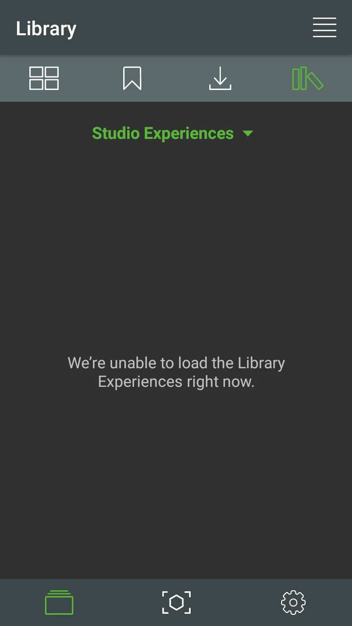

Unable to get the list of Experiences published in the Vuforia Portal.
I have created the mobile experience using the Vuforia studio and Published it into the "Default Experience Service URL".
Now I have installed the "View" app in my andrioid mobile and provided the Default Experience Service URL in URL section of Settings page.
But in Library-->Studio Experices section I can't find the my published experience.
Please suggest.

You will find there only experiences published with targets that are not ThingMarks. Did you use a ThingMark? If you you just need to scan it.
