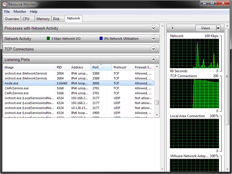

  • In Windows, check if the port 3000 is used only by Vuforia Studio and not another process
         Steps  to check that :
  1. In Start menu, execute this command resmon.exe
  2. In Resource Monitor program, in Network tab, in Listening Ports panel, click the Port column to sort it
  3. Scroll down until to find a line with a value at 3000 in this column
  4. Please see this screenshot, node.exe is Vuforia Studiovuforia_studio_node.exe_port_3000.png

Port 3000 is unblocked, no firewall restrictions.
