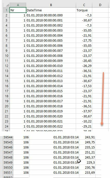

I am sorry for the delay but there was no time to test. Now I tested it and it works but it was for me also not easy to manage it. Yes for me the CVS methods are working only for strings- I tested a lot of formatstrings for date but it was not working so my solution is to use a service which create first a InfoTable with strings  and then in a second service  (is possible also in one service) to convert it to a correct data type.
So I have e.g. the following excel table:
2018-05-24_17-25-37.jpgThe excel table was added to repositrory as earler was already mentioned:
So I defined two datashapes - the first one DS1 - there  the fileds are defined only as string and a second datashape DS3 where the field are defined with the correct data type. Also here have to mention , that I had difficulty to convert the german date format with milliseconds and separtor to the correct number. So the solution was to split every thing! So the source Data String was some thing like: "01.01.2018 00:00:00.010"
So I defined the first service   testReadCSV (retuns InfoTable) which convert only to string -something like this:
And then in the second service  convertTypeReadCSV  (retuns InfoTable) converted it to the correct dataformat:

 So that when I tested it got the desired result:

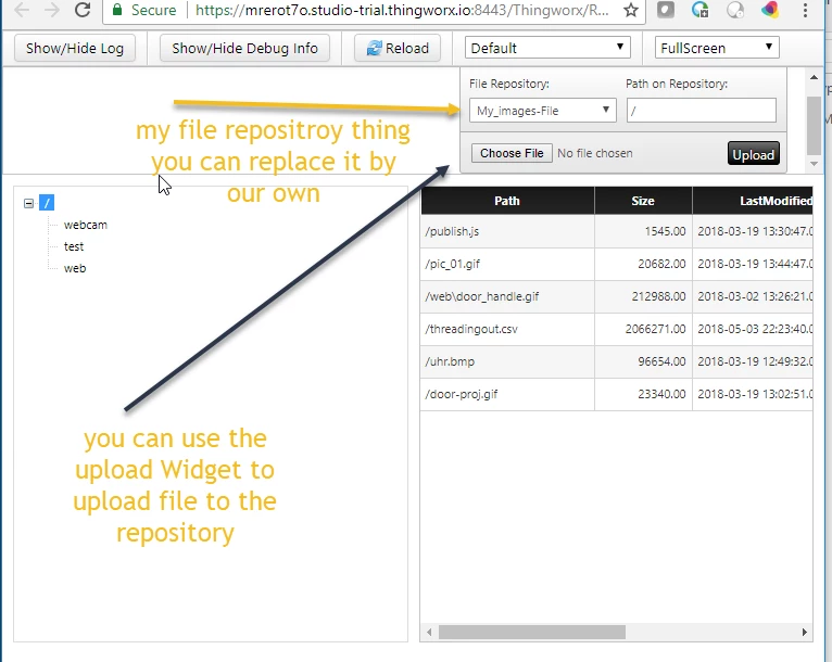

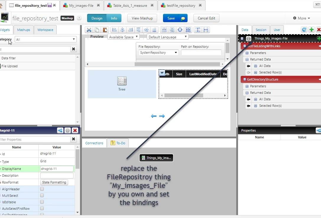

I think the documentation contains some very helpful examples for the definition of services
So another question is how to add this to the Thingworx instance. In the article is mention to use the FileRepository services. So here is a mashup which could be  helpful to upload files to a File repostitory (Entity for Mashup and demo File repository)
You can import it - so it contains a mashup + demo FileRepository thing (thing which use as template FileRepository Thing Template)
So you can change the FileRepositroy thing with your own. The upload element could  select all elements which are availible as repostory in Thingworx  (using the FileRepostory template) but you will not see it in the tree. You can replace in the mashup the repository file "My_image-File" by your own repositroy file and set the same binding2018-05-04_10-39-22.png
