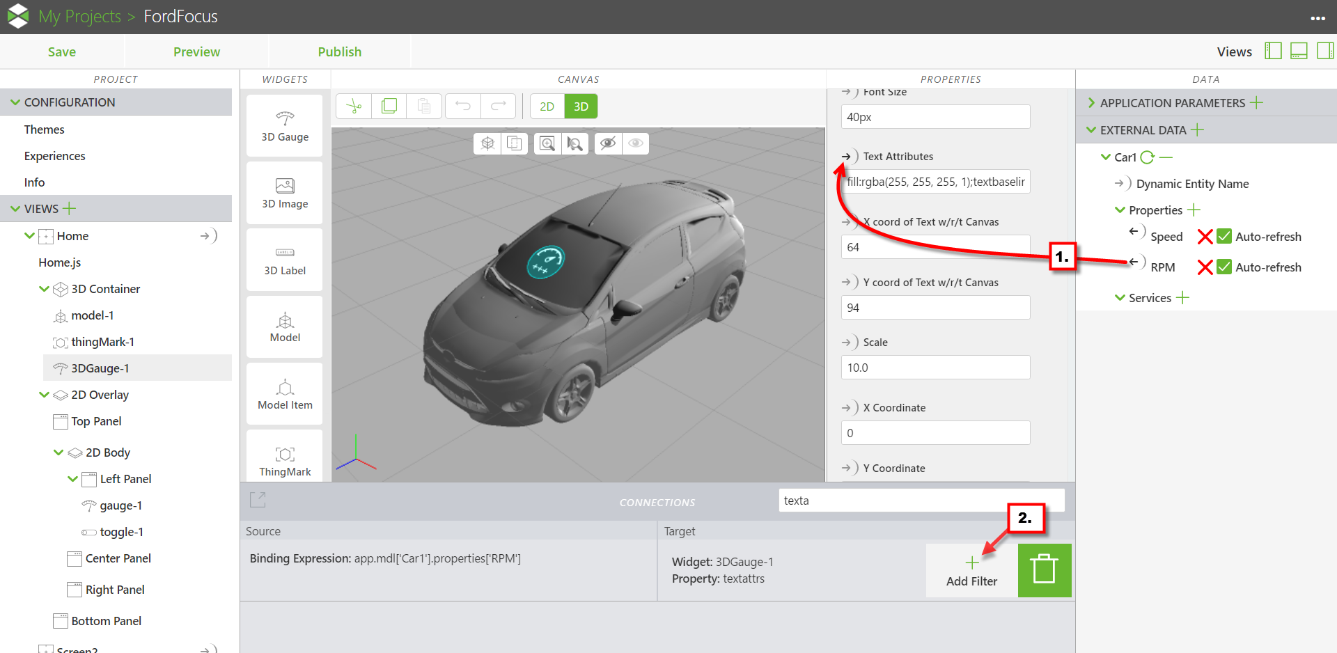

State-based rendering of properties that come from user inputs or from connected ThingWorx data is a common requirement.
Think about the following scenario: from ThingWorx you get the state of a as one of these values: [ OK | At-Risk | Issue ].
You would like to visualize it with a 3D image or a changed 3DGauge icon.
You can achieve that easily with a ThingWorx Studio functionality that is often overseen: The Connection Filters.
With connection filters you can achieve a lot of very nice a common features, mainly:
  • number and date formatting
  • value pre- and postfixing (specifically units for numbers but also anything else)
  • state-based formatting, e.g. changing the image or style based on a number change
Here is what I mean in practice:

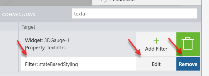

Step 1:
Step 2:

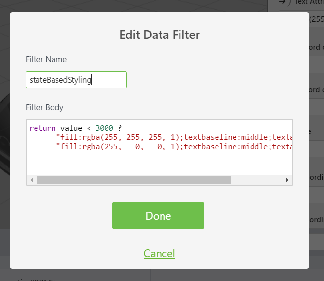

Here is the stateBasedStyling Connection Filter content:
return value < 3000 ?
   "fill:rgba(255, 255, 255, 1);textbaseline:middle;textalign:center" :
   "fill:rgba(255,   0,   0, 1);textbaseline:middle;textalign:center" ;
value is a key word and represents the value on the connection before applying the filter function. The returned value is the one that is used in the bound-to attribute. I found that the expression has to be a one-liner (technically), i.e. you have to start your expression with 'return' and can't do something like:
if(value < 3000) return "fill:rgba(255, 255, 255, 1);textbaseline:middle;textalign:center";
else return "fill:rgba(255,   0,   0, 1);textbaseline:middle;textalign:center";
Resulting Filter in ThingWorx Studio:
You can add multiple filters but I didn't check yet in which sequence they'll be evaluated (top-to-bottom or bottom-to-top).
