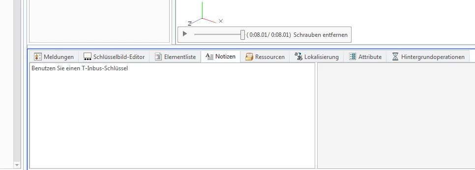

Hey there,
i want to get the my notes from my animation in Creo Illustrate. Is it possible to get this infomation in Vuforia Studio?
I added the notes here:
In my case I want to show additional infomations while the animation.
Jonny
Best answer by whity
Hi Jonny,
have a look over here:
https://community.ptc.com/t5/Studio-Tech-Tips/Display-sequence-step-names-from-Creo-Illustrate/m-p/534911
Greetings
whity

Oh sorry. Thank you for this hint.
