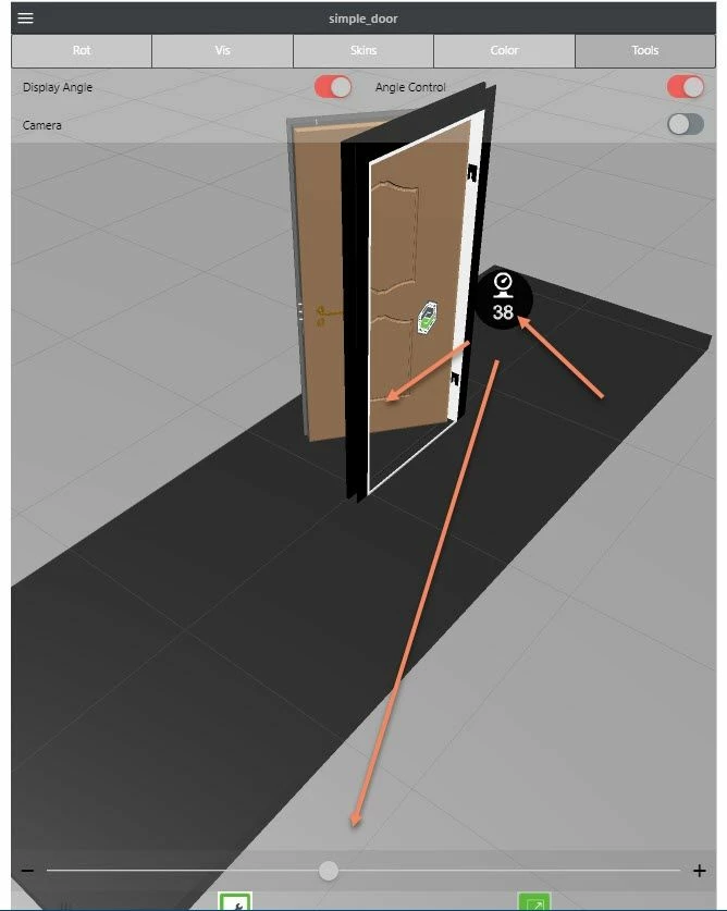

Hi @Writer_test ,
I do not think that in generally this should be a problem and it should work. So we need to check what are the particular bindings. Here e.g.  I have more complex case where I could rotate a door via slider. Otherwise the door could be rotated by event coming from Thingworx. But there is no problem and the slider is still updated corrected when the angle change and the door is rotated.
May be if you provide more info about your implementation, so I could check  what could be the problem
In the door example I used a $watch construct where I checked the value of parameter and then synchronized the values of the door rotation and the slider. so here when I change the parameter door_angle this will lead to synchronization of the both. May be you can use similar approach

Hi @Writer_test ,
I am  sorry for the delay! Now I did see your comment. If this issue does not exist, please ignore this post
So, what I think - the issue is based that your binding is on different things.
One time you have binding to app parameter and the app parameter has binding to the model
On the other hand, you have binding from a slider directly to the model.
I think the proper way is to have a binding in two direction sliders to parameter and parameter to slider. And second time a binding from parameter to the model widget rotation angle
This will make the behavior also consistent  if you change the application nparameter via JavaScript
