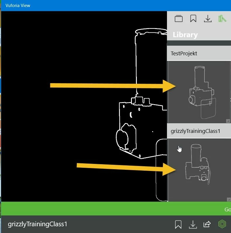

Another option is to  copy the project e.g. 30 times and then for each copy to create an additional model target. Then for each project you can use Project Thumbnail which show the different model target. Let say your projects are published on server with particular URL. In this case you can set in Vuforia view the URL to the server where the projects are published and then see the project as menu for selection on the  Library tab. This is similar a suggested option by   @sdidier but do not require some additional preparation of the view selection.
