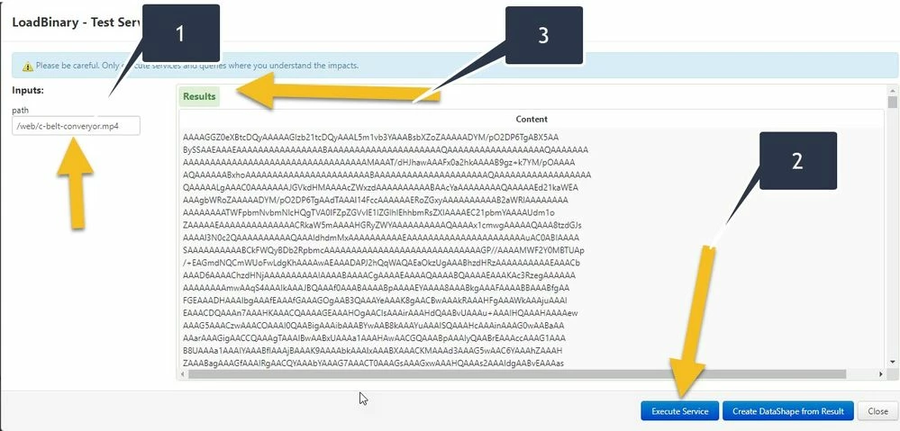

1.) checking the path of the path on the repository:

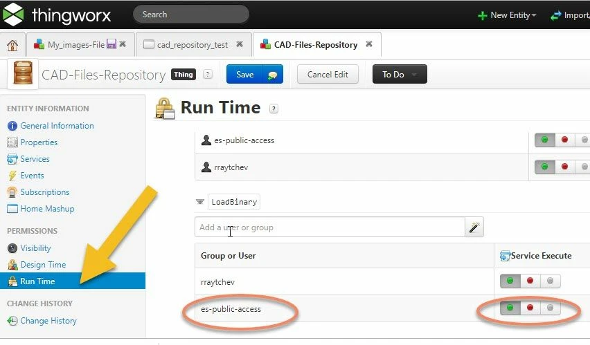

2.) set the permission of the service LoadBinary of the repositorything  to run for 'es-public-access'

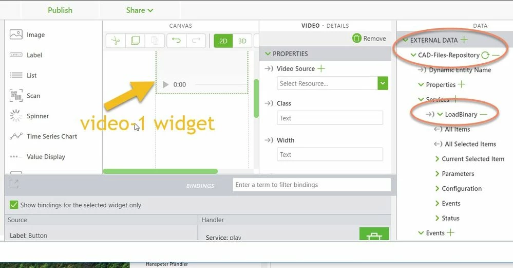

3.) add the service in the External Data in Vuforia Studio project :

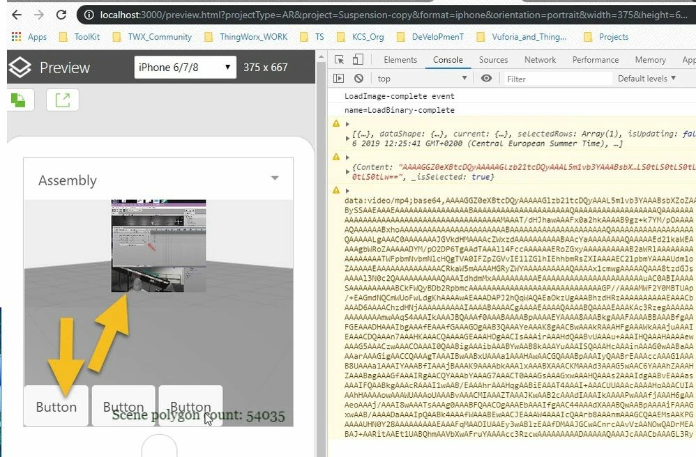

4.) add e.g. a button click event to the video widget play service:
5.) add the following javaScript code;
////////////////////Issue with read video from repository
$scope.GetVideoFromTwxRepository = function(path) {
 $scope.$applyAsync(function() {
 $rootScope.$broadcast('app.mdl.CAD-Files-Repository.svc.LoadBinary',
 {"path":path}
 );} ,500 );
 console.log("after calling GetImageFromTwx");
 $scope.$on('$ionicView.afterEnter', function() {
 // register the LoadBinary-complete event + callback
 $scope.$root.$on('LoadBinary-complete', function(event, args) {
 console.log("LoadImage-complete event");
 console.log("name="+event.name)
 console.warn(args.data);
 console.warn(args.data[0]);
 var ret_str='data:video/mp4;base64,'+args.data[0].Content;
 $scope.view.wdg['video-1']['videosrc']=ret_str;
console.warn($scope.view.wdg['video-1']['videosrc'])
 //call the function to laod the mp4 file to video source of the video widget
$timeout( function () {$scope.GetVideoFromTwxRepository(
'/web/c-belt-converyor.mp4'
);},500);
6.) Test it in preview and on mobile device- I tested in Android and IOS Ipad 6 - and it was working fine
