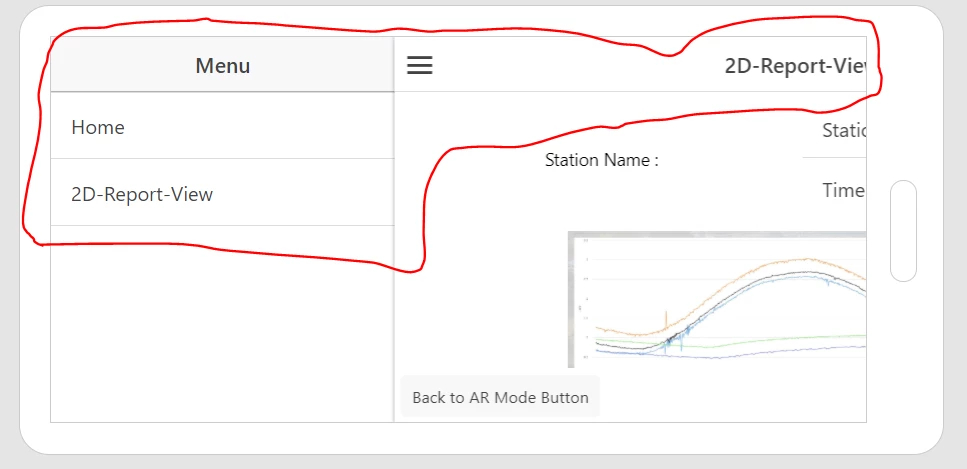

I would like to make view-navigation-menu go hidden as i configure it on info menu.
It's not go hidden as configured. as shown below

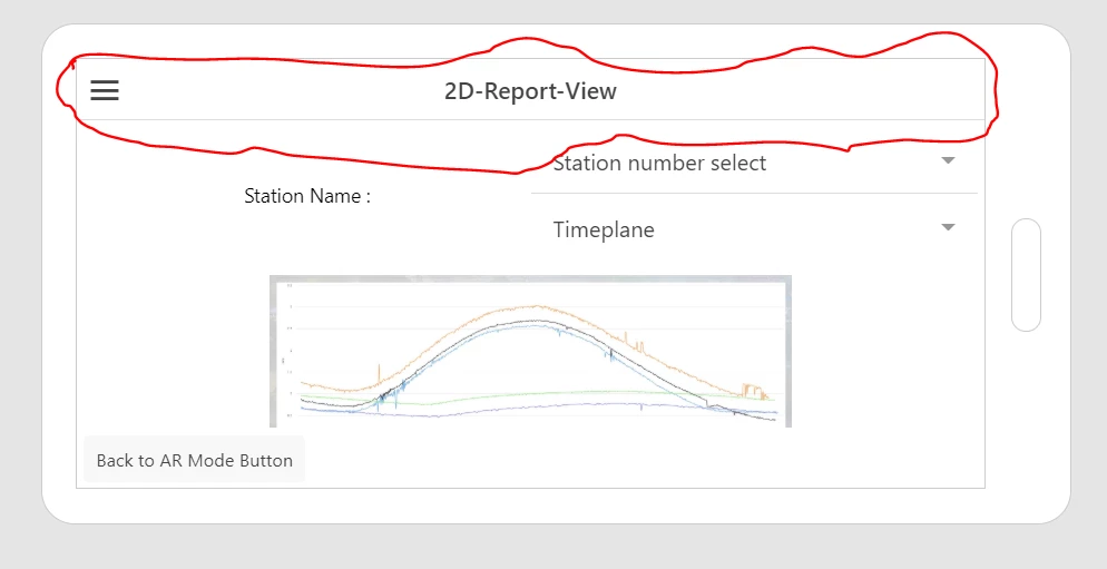

Paitoon1-VisitorAuthor
Oct 2, 2019 3:23 AM UTC
Yes..... I have footer in 2d-report-view. so i remove and update about configure hidden again and now hidden menu work. it hide`!! Thank you
