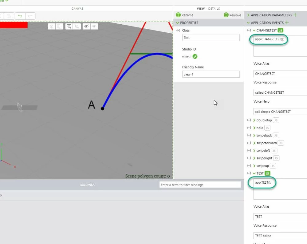

1.) I defined 2 Application Event/Command: TEST and CHAGETEST:

So here are 2 important points:
-we will define the callback function app.TEST for the  "TEST" command/ event when we enter the Home view.
-The CHAGETEST will modify the definition of the callback function app.TEST
- when we call TEST here we will enter the view SECOND_VIEW. In Second VIEW we will override the function again by other definition (in SECOND_VIEW.js):
