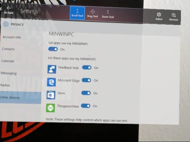

Hej guys,
we received the feedback that voice commands were not recognized appropriately within the View app (the app commands).
The reason for that were the privacy settings in the hololens.
So the settings should be updated to:
  1. Settings/Privacy/Other devices/ThingworxView -> on
Should look like this:
